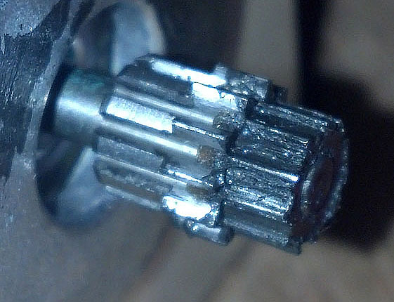

My extruder motor had been making some clicks lately, but last night half way into a 14 hour print, the extruder stopped working and just clicked horribly. I took apart the gearbox on the stepper motor, and it looks like the pinion gear is worn. The planetary gears look just fine.
So, a couple of questions: the pinion gear appears to have three teeth areas - one at the outermost tip, a thin band of larger teeth around the middle, and another band at the innermost area. The inner tooth area appears to engage the planetary gears nicely, so I'm wondering if it would work to just flip the pinion gear over so the nice sharp teeth are outermost. It seems like it would work, but I can't seem to remove the gear. Is there a trick to it without damaging the motor?

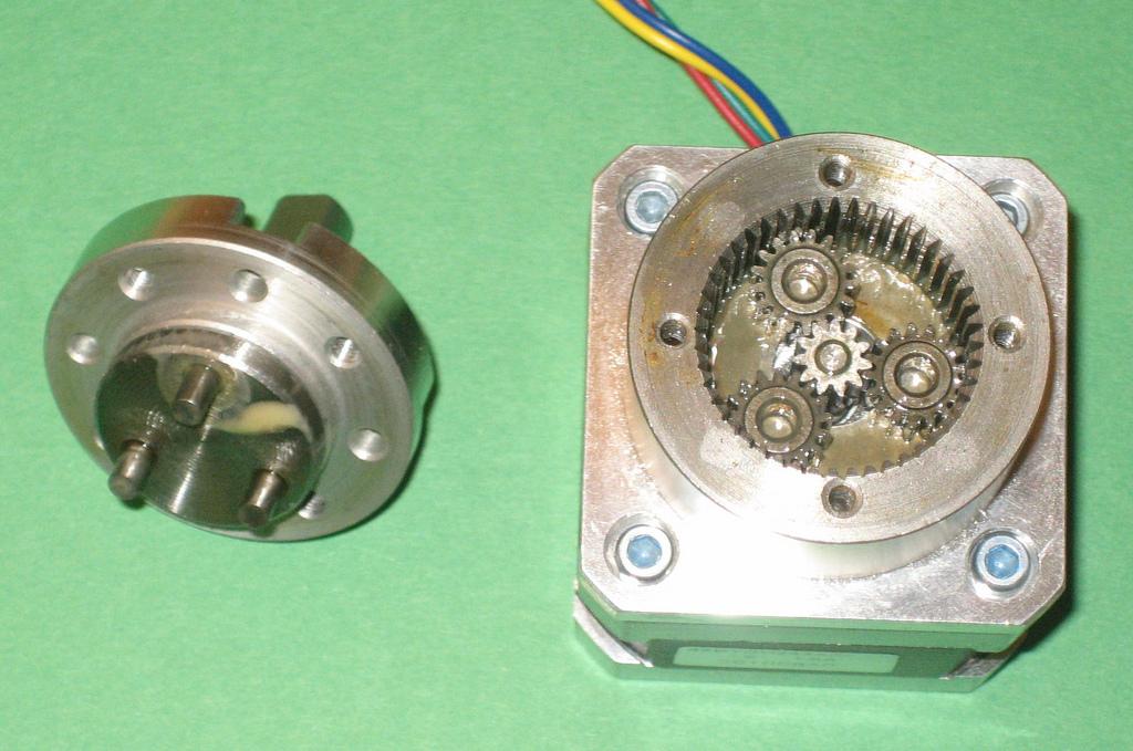

I think I found the answer to my question. I came across a photo of the pinion gear on the old MG Google group, and I see that it should have much sharper teeth than the inner teeth on my gear. The inner teeth on mine are kind of squared off. See photo below.
Flipping the gear will probably not work even if I could get it off the motor.
So, it's time for new motor. Can anyone confirm the proper gear ratio for my 6/2013 printer? It seems to be 5:1 but I want to be sure it's not 13.6.1.
Is there any difference between a 5:1, a 5.2:1 or a 5.18:1 ratio? I don't understand the extra numbers.
This is what mine SHOULD look like:
