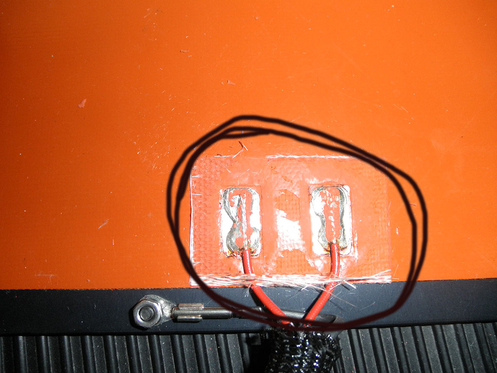

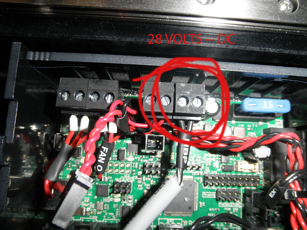

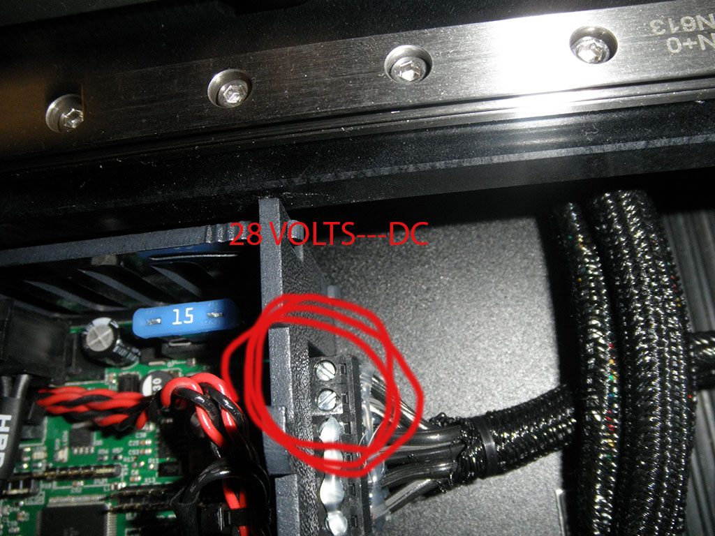

First off---I wish to thank all of those who have responded and for those who will respond but have not yet done so. I got the printer in mid August so I sure it's the update version. Fuse is good.
1.I checked the inputs on the back of the unit and enclosed pictures of what I check and the results. 28 volts
2.Check the voltage coming out of the RAMBo board and also saw 28 volts
3. I pulled the rubber coating off the back of the bed and check for voltage there, NOTHING. If I pull the black twisted pair of wire that go towards the center of the RAMBo board the temp in the software goes to zero.
All connectors see good, no melting

Follow the wires from the bed back about 2 ½ “ back under the black protective sleeve there is a connector. I bet yours came unplugged I have had this happen.
