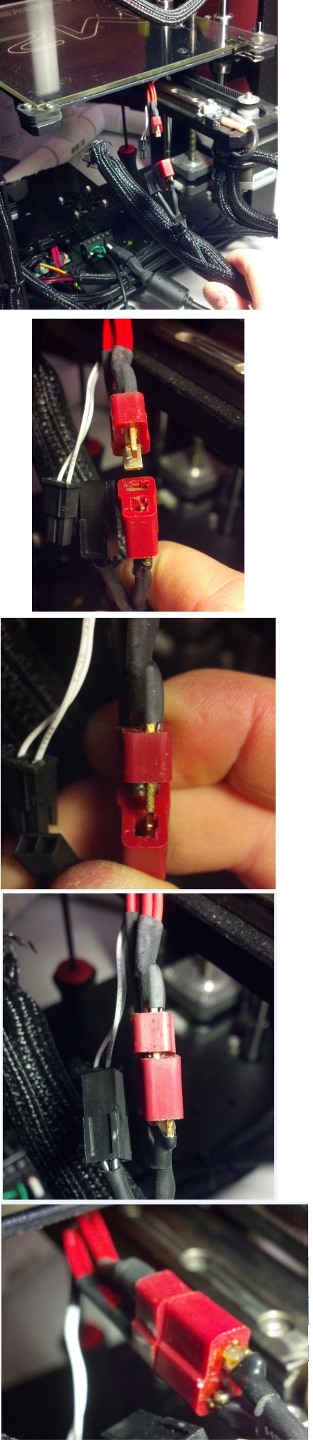

I've had my M2 for almost a year now, and I've struggled with the red plug the whole time. I usually just revert to printing in PLA and not worrying about it. When I try to plug it in, it never has a 'solid' connection. It will just fall out. It almost looks like it could be an incorrect plug because of how the metal prongs line up. I can get it to heat to the bed when I sort of twist the plug to engage the two prongs. See attached pics. What can I do about this? Thanks guys!

Definitely a bad connector. They should seat tightly, and line up perfectly. A loose HBP connector is actually pretty dangerous; it can pretty easily smoke your wiring (I do not ascribe to the idea that this is likely to start a house fire. . . but once you've carbonized your wiring, you've just made it a lot harder to repair properly).
Please contact MakerGear to see what they can do about it.

It looks to me like on the female side the one tab is pushed over to the wrong side. Like the blade is going in on the wronge side of the female contact. Ill have to take a look at mine. Everything should line up and seat tight with that and the o ly thing i can see is what i just said.

I just looked at my two connectors, and the female side (on the wire harness) of the connector in the photo looks exactly like mine, while the male side (on the HBP) looks like a mirror image! Which is bizarre. But that's what I'm seeing in the photo vs. what I'm seeing on my M2. As you can see in the middle picture, the contact goes all the way through the connector, which is just molded around it. So either there are two types of this type of connector, in left-hand and right-hand version, and the wrong one got put on the HBP, or else the contact got shifted during the manufacturing process (I'm not sure which of those two would be less likely. They both seem unlikely, but there's the proof, in the photo).
I'd say you're due for another HBP from MakerGear. Send yours back to them and let them send it back to the manufacturer for failure analysis or quality assurance or whatever it is that they do with those things.

I got a hold of Josh from Makergear and they're sending me a new HBP power harness to use. Hopefully it's not too difficult to install!
