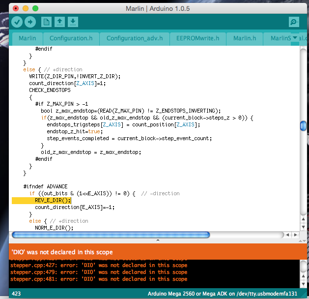

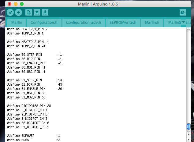

ok first pic is after i swapped the values. the e1 values i made eo and the e0 i made e1. second pic is the error i got when i compiled.
Screen Shot 2014-10-30 at 10.11.31 PM.png (85.71 KiB) Viewed 14588 times
Re: extruder stepper grinding

Glad you got it sorted out. Regarding the firmware error, not that it's helpful at this point, I didn't realize the stock firmware had -1 as the pin numbers for the E1 pins, I must have been looking at my dual extruder firmware. -1 means undefined in this context. Sorry about that.

Okay. My suggestion was not to configure it so that E1 was active while E0 was undefined, rather to configure E0 to use the pins for the second extruder headers, effectively swapping them. Just in case you or someone else needs this in the future, the correct numbers are:
#define E1_STEP_PIN 33
#define E1_DIR_PIN 42
#define E1_ENABLE_PIN 25
#define E1_MS1_PIN 63
#define E1_MS2_PIN 64
Just swap those in for the E0 pins.
