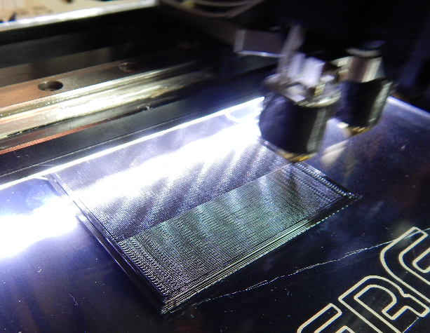

Edit: I really like printing with infill at 0 and 90 degrees, instead of diagonally. Here are the second and third layers (MG black PLA, beta dual hot end, hair spary, bed at 70 C, nozzle at 223 C):
Here are layers 2 and 3 of my big simple block. Now, how fast can I print this?
