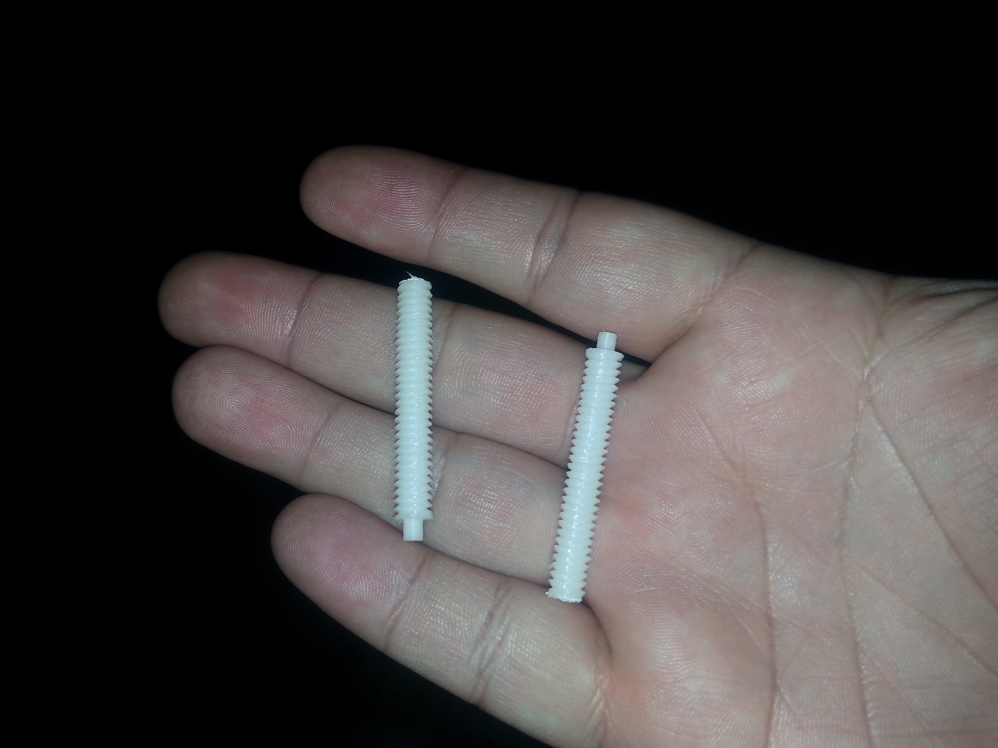

Don't be silly, you don't have to split and glue threads. Just print multiples at once.
These are ABS @ 0.08mm, printed vertically, 4 at once on a raft.

If you wanted to print buttress threads, that'd be the ticket, but those aren't really suitable for use with a standard nut. The problem isn't the vertical resolution, it's the lack of support on the bottom side of the thread form: notice the difference between the upper and lower sides of the thread.insta wrote:Just print multiples at once.
Splitting the "bolt" in half won't work for fine threads, though, because the XY resolution isn't good enough. In round numbers, the thread crests will be 0.5 mm, which means you can't have a pitch much less than 2 mm; a 1/4-20 or M10-1.5 bolt pushes the limits pretty hard.
If it's at all possible, embed / epoxy a real metal screw in the part and move on...
