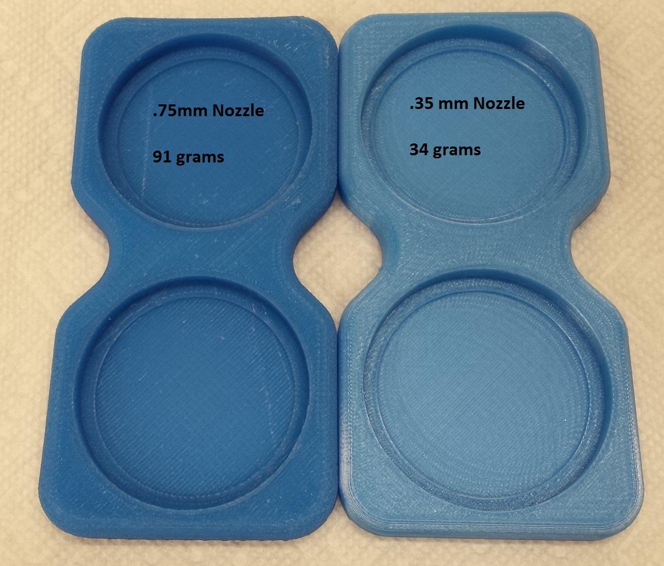

I was able to get the .75 mm nozzle to work, but the problem I am running into is that its laying down 3 times as much material...... so It kind of defeated the purpose since the time savings will be eaten up by material cost.
I have attached a sample print of the same part printed with a .35 mm nozzle and .75 nozzle. You can see how much darker the .75 nozzle print is because of all the material used. ( both parts were printed using the same material )
I have also attached 3 screen shots from Simplfy3d profile for the .75mm nozzle.
Kind of a head scratcher...

Some of that difference can be accounted for because you are laying down two solid perimeters at 150% of what you would normally be doing with a 0.35 mm nozzle, so your perimeter is the thickness of a 3 layer perimeter.
I don't know what accounts for the rest of it. Presumably, 30% infill means lay down a pattern to cover 30% of the surface area, regardless of extrusion width. So you should be seeing no more than a 50% gain in weight.

kentd wrote:its laying down 3 times as much material
I think that's what the parameters call for...
For a 0.75 mm nozzle, forcing a 0.6 mm width requires the extruder to produce a thread narrower than the nozzle, which doesn't work well. Set the width to about 0.8 mm, maybe 0.9 mm.
Using a 0.2 mm layer thickness with a 0.75 mm nozzle doesn't take advantage of the material flow rate. That should be around half the nozzle diameter, maybe a bit more: try something close to 0.45 mm for starters.
Using an Extrusion Multiplier of 2.0 doubles the amount of material laid down. That number should be very close to 1.0.
You'll probably need more retraction, because a 0.75 mm nozzle has nearly 5 times the area of a 0.35 mm nozzle: there's a lot more molten plastic ready to drool out that bigger hole, so you must yank it back further.
Once you reset those values, calibrate the actual output using a series of thinwall boxes. When you get everything right, the single-thread wall thickness will be spot on 0.8 mm (or whatever you set). When you measure the filament diameter accurately, the slicer should come pretty close to the right output, whereupon you tweak the Multiplier to get the exact width you're specifying.
For the 0.35 mm nozzle on my M2, I use a thread 0.4 mm wide x 0.2 mm high = 0.08 mm². For a 0.75 mm nozzle, using 0.9 mm wide x 0.45 mm high gives a 0.4 mm² thread. That's 5 times the plastic volume per unit of XY length, so your prints will take maybe 1/5 (that's optimistic) of the elapsed time at the same XY speed.
However, the vertical resolution won't be what you're used to. If you cut the layer thickness back to 0.2 mm, then you double the print time. You probably can't double the XY speed to compensate, but some experiments would be revealing, because, at some point, the extruder heater won't be able to deliver enough power to melt the filament fast enough to keep up with the required output volume. Start slow and go faster only after you get good, stable results at "normal" speeds.

Ah, I hadn't noticed the 2.0 extrusion multiplier. That, plus the 1.5x amount going into your perimeters, would give somewhere between 2-3x the amount of filament, which is what you're seeing.
