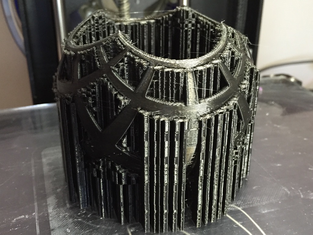

Well, I gave it a shot. 1mm spacing support with my usual print settings. It printed just fine, but I was a little too vigorous in removing the supports and broke off parts of the rim, then I gave up the rest for lost. Here's a photo of it in its unpeeled state:
The part itself seemed pretty good, it's just getting the support off that's a pain. If you were patient and took your time with it, which I was not, I'm sure it would turn out nicely.

Not bad... 1mm spacing? I'm going to have to try that. I'll post how it turns out.
