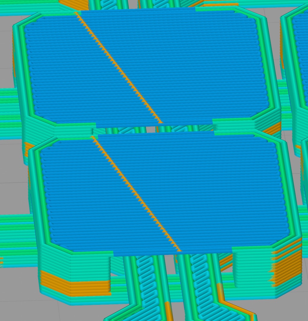

Looks okay to me. Here's how S3D handles the cap bridging, it opts to bridge just the interior gap rather than the whole thing:

Post by Tim » Wed Feb 11, 2015 3:49 am
Since Jin beat me to it, I can only concur that Simplify3D does the right thing for all the bridging.
