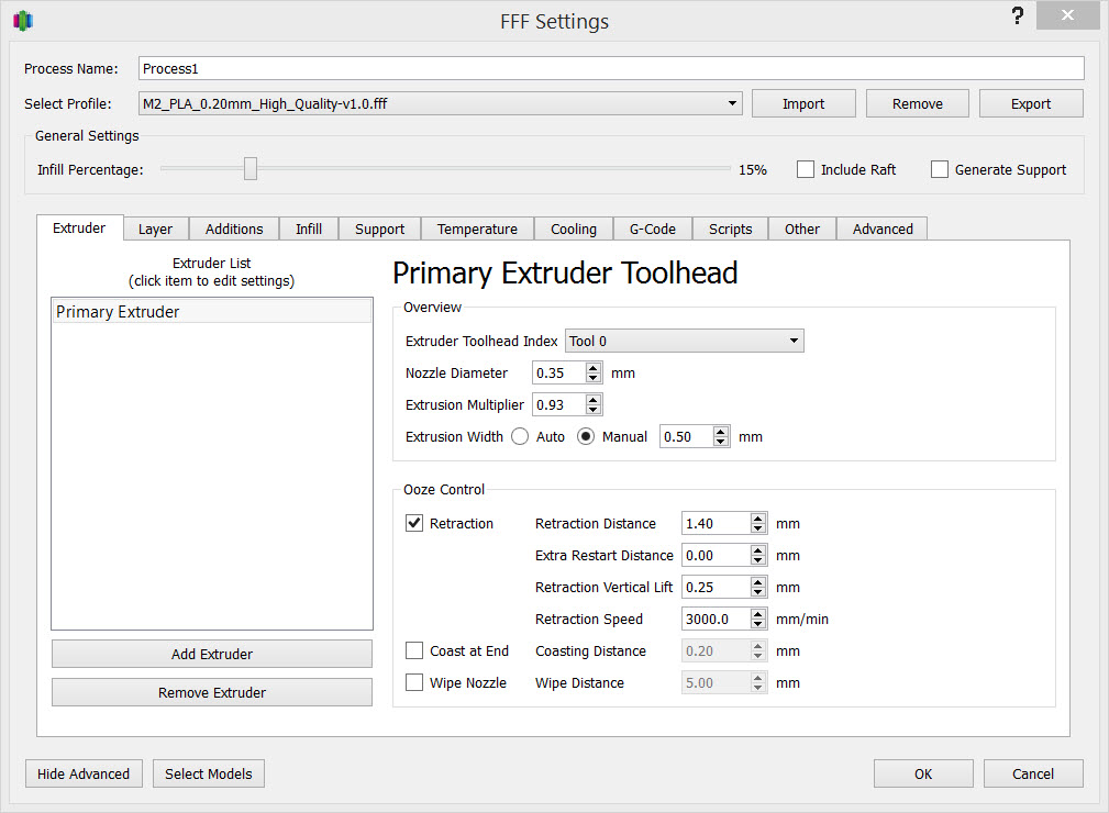

I haven't been using my M2 very much lately but tried a couple prints today in advance of "showing it off" to someone looking to make a purchase for a local school. The M2 has been great so I made the recommendation for them to get the M2 without hesitation. I am having some issues obtaining the quality of prints that I use to in the past. I am trying to analyse what has changed and it seems that everything but the M2 has. My computer crashed so I re installed and now have the latest Simplify3D. The settings I use to use were lost but they were basically ones that I had downloaded "rsilvers - M2_PLA_0.20mm_High_Quality-v1.0" which I have attached. I re-downloaded the file and got everything setup, loaded the filament and tried to print. I am using Red Makergear PLA that has been properly stored. I am getting allot of extra ooze during travel. I am also getting blobs at start points that are quite noticeable as its printing. The layer does look smooth but instead rough. I think the rough look is more along the sides of each line it lays down. The bottom of the print has a pronounces edge to it. I triple checked the bed for level and the z stop. I have it set to .008" which is what it has been at in the past. The glass is clean and adhesion seems ok. I expect that it is my settings and not a problem with the M2 itself but is there anything on the M2 I should check? It has not been disturbed at all since its last use which has a been a couple months. If anyone would be so kind to offer some suggestions or even another profile to try I would appreciate it.

Yes, photos of the model with the issues you're trying to fix would be helpful. Your settings seem fine, and if you've printed with them before without issue, I wouldn't look there first. You've already preempted the first two common suggestions, though, by saying you've checked your bed height and that your PLA was properly stored. What does "properly stored" mean to you, though? PLA is aggressive at picking up moisture.

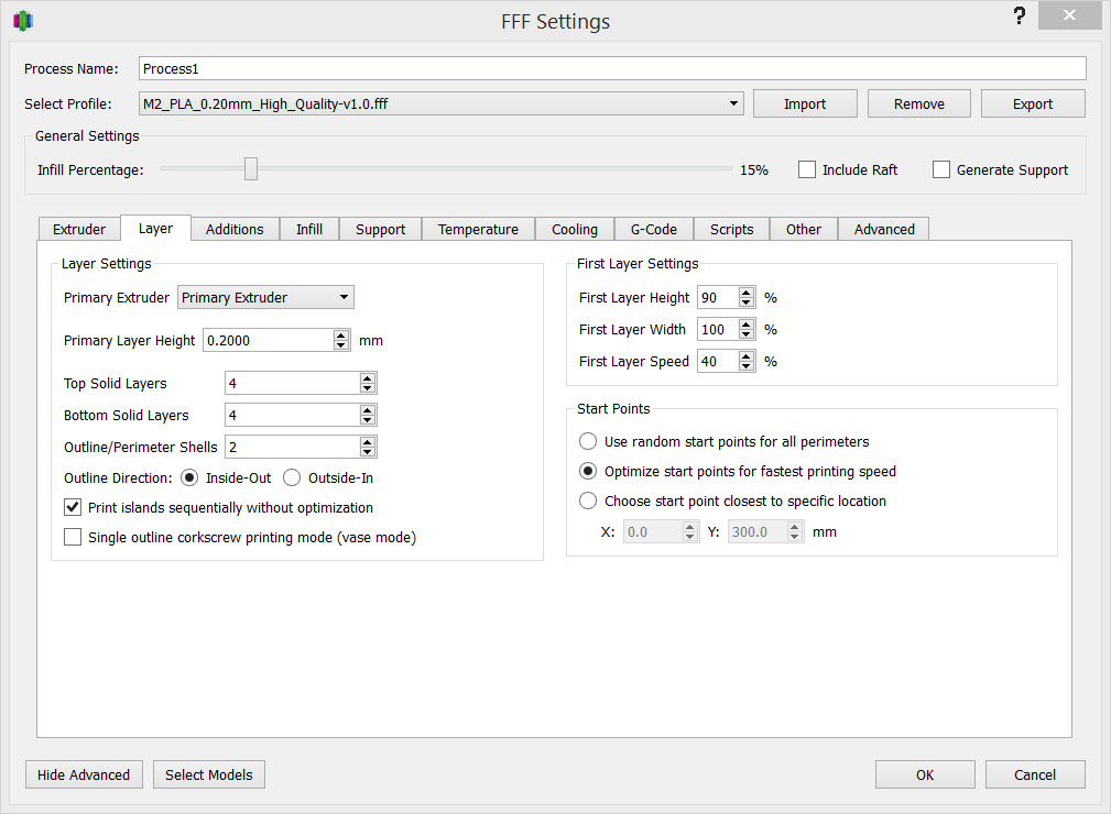

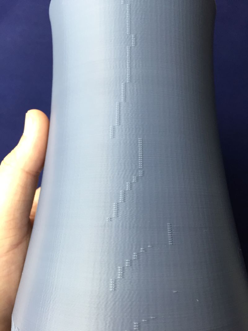

Hello everyone. I didn't want to start a new thread. Can anybody tell me pls what causes this? I also included my settings. Print with ABS, 245 degrees, heated bed. 0.35 nozzle

"Optimize start points for fastest printing speed" makes the seam position depend on the rest of the the layer, producing the semi-aligned pattern you're getting.
"Outline Direction: Inside-Out" means that excess plastic on the perimeter thread can only go outward, which tends to accentuate the seam.
The zits most likely occur at the end of the perimeter thread, where the nozzle pauses while retracting. The "Coasting Distance = 0.8 mm" may not allow enough time to depressurize the hot end; increasing that should reduce the zit size.
The "Retraction Distance = 2.0 mm" may be a bit too high, because there's no point in retracting after the drool stops. Reducing the distance also reduces the time the nozzle spends at that spot, which reduces the amount of heated plastic.
The "Retraction Vertical Lift = 1.05 mm" lifts the nozzle at the end of each layer and lowers it at the start of the next one. Because the Z axis has low speed and feeble acceleration, that means the nozzle spends plenty of time at that spot. If you don't absolutely need axis motion to avoid another problem, turning it off should improve performance and print quality.
The "Wipe Distance = 6 mm" moves the nozzle over the existing perimeter, but without extruding. That may contribute to the zit's width, because it's smearing the remainder of the pressurized plastic across the top of the perimeter thread.
I'd start by increasing the Coasting Distance, then reducing Retraction Distance: change one thing at a time and measure the results!
Thank you! Your suggestions significantly improved print quality!
