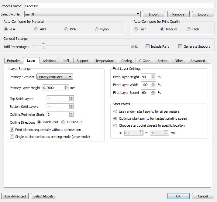

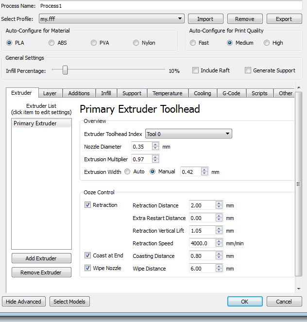

Hello everyone. I didn't want to start a new thread. Can anybody tell me pls what causes this? I also included my settings. Print with ABS, 245 degrees, heated bed. 0.35 nozzle

nokianich wrote:I didn't want to start a new thread.
It's a good idea to start a new thread for a new problem that's unrelated to the previous problem and discussions.
"Optimize start points for fastest printing speed" makes the seam position depend on the rest of the the layer, producing the semi-aligned pattern you're getting.
"Outline Direction: Inside-Out" means that excess plastic on the perimeter thread can only go outward, which tends to accentuate the seam.
The zits most likely occur at the end of the perimeter thread, where the nozzle pauses while retracting. The "Coasting Distance = 0.8 mm" may not allow enough time to depressurize the hot end; increasing that should reduce the zit size.
The "Retraction Distance = 2.0 mm" may be a bit too high, because there's no point in retracting after the drool stops. Reducing the distance also reduces the time the nozzle spends at that spot, which reduces the amount of heated plastic.
The "Retraction Vertical Lift = 1.05 mm" lifts the nozzle at the end of each layer and lowers it at the start of the next one. Because the Z axis has low speed and feeble acceleration, that means the nozzle spends plenty of time at that spot. If you don't absolutely need axis motion to avoid another problem, turning it off should improve performance and print quality.
The "Wipe Distance = 6 mm" moves the nozzle over the existing perimeter, but without extruding. That may contribute to the zit's width, because it's smearing the remainder of the pressurized plastic across the top of the perimeter thread.
I'd start by increasing the Coasting Distance, then reducing Retraction Distance: change one thing at a time and measure the results!
Thank you! Your suggestions significantly improved print quality!
