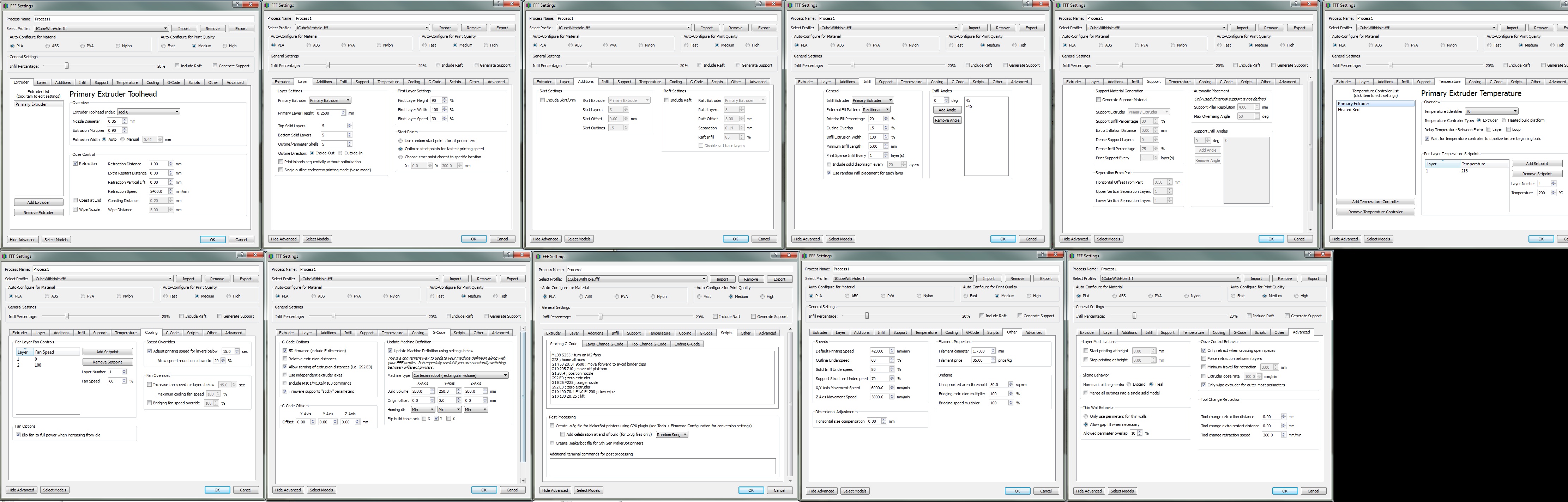

We're using Simplify3D to slice the models and run Gcode. I'm attaching a screenshot of my slicer settings. We're using black or white PLA material for the prints.

This is a firmware thing. It's a known issue in the way Marlin calculates flow rates, and there's not an easy fix. The best thing to do for now is oversize the holes, or use the "adjust in XY plane" option on the last tab in S3D.

Thank you for the replies. I am sure our extruder is probably in need of calibration so that'll be my starting point. We haven't played with that area of the settings too much (just arrived at something that worked pretty well and stuck with it haha) so there's definitely room for improvement.
