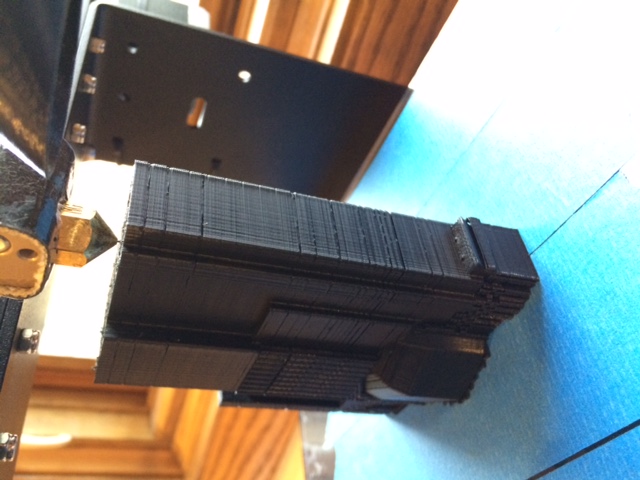

I did recently switch filaments. When I ran into all the problems I was printing with black Makergear PLA, then I thought maybe that was the issue randomly (even though it was printing just fine before), so I switched to Hatchbox Red PLA (which prints great on my Printrbot Metal Simple), and that is when I ran into the really bad extrusion problems, after you mentioned that, I switched back and managed to get almost all the way through a 4 and a half hour print, though there was some weird line issues going on. At around 40 min left on the print, it randomly stopped extruding all together, and the part which has 4 line thick walls, with a 15% infill I could break apart in hand at the various weird lines. I'm attaching a pic of what it looked like and my Simplify3D profile. I've been working on this for about two days now, all day, so like 20 hours with little progress (other then getting the bed finally leveled right and the Z stop at the right height). It's all starting to really piss me off haha.

if i was you i would make 2 changes to see what happens. #1 change your perimeters to outside first then inside. your parts will be a bit more accurate and the outer surface wont be affected by the inside extrusion. i get slightly cleaner walls that way. inside then outside is great if you have a part with alot of steep overhangs. #2 your temp is a little low. especially with the fan on. try it at 220 and see what it looks like. its probably having a tough time pushing out the filament. remember the temp will run different than your printerbot.

Alright I'll try that, yea I usually have the temp at 215, I actually forget why I lowered it down.

Two things strike my eye:
1. Your "fast" layer height is 0.3mm. That is on the margin of what your nozzle will realistically be able to handle. .20 or .25 at most is more common.
2. Your temperature is 200 for PLA. Try warmer. My stock PLA temp is 225.
Oh, I see jimc already said #2.

Thanks for the help guys, I switch the outline to outside-in and changed the nozzle temp to 225 and it's all working great now.
