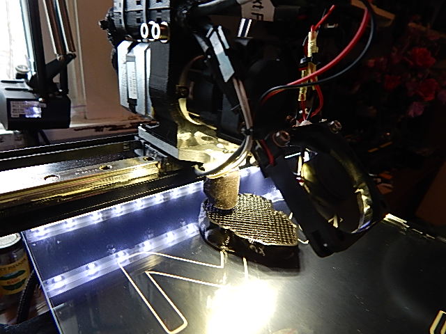

You will like the V4. The hot zone in the hot end is shorter (not all the way up the tube), so it seems to drool less and put down exactly what you tell it to. I'm running the stock MakerGear Bigfoot head demo G-code file, unmodified, with MG black PLA at 218 C, bed at 60 C, and the quality is just super. The slicing used for it uses 3 perimeters, from the inside out. I have a bunch of LEDs on my M2, some on the fan bracket above the hot end, and some on the frame. When it is printing the perimeters, you can see clearly which is being printed, and when all three are done, the surface of the 3 perimeters is flat and shiny. Just awesome.
Another nice thing about the V4 hot end is how it's mounted. There's a screw you can loosen and slide the hot end up or down just a bit. Once you have the bed level and true, if the Z height at home is off just a bit (say, less than half a millimeter), you can get out your 0.005" feeler gauge, slip it under the nozzle, adjust the final height perfectly by sliding the hot end in the mounting bracket, and clamp it down with the M3 screw. (In the photo, you can't see the clamp screw because it's behind the hot end wires.) NOTE: When you install your V4, follow the directions on wire routing. Don't follow my picture --- I've done a bunch of other goofy stuff with the fans, etc., and I've just got stuff routed wherever for now -- need to dress things to final yet!)
Just don't stick the hex driver in the fan. Now that I've jinxed you, good thing you got a spare fan!
