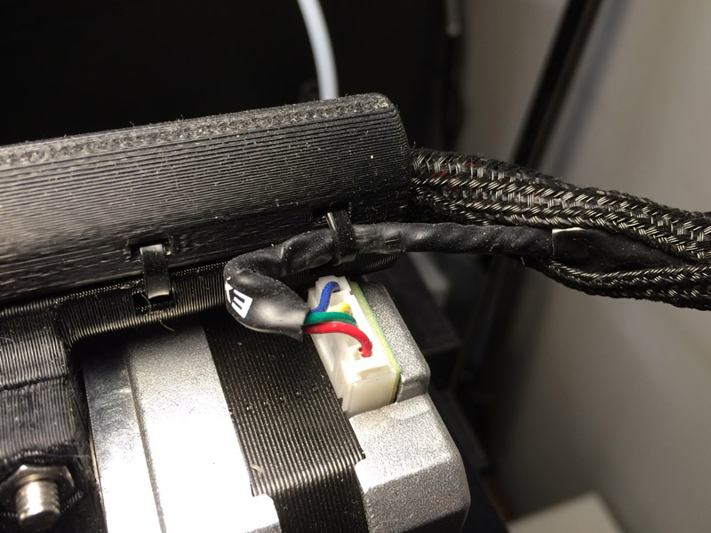

So I have a problem with the wires staying in the extruder motor on the white connector... those pins give and the wires come out wrecking a print.
I've emailed tech support the pics, etc. without a reply for a week. Called today and no answer. I've been down for over a week. Every time I try and fix the connector pins, they fail at some point in a 10-20 hour print so I'm not sure what I can do from here on out.
I've got the 24V M2 with V4 head. It works awesome and I'm now to where I'm wearing things out I guess.
Does anyone know where I can get that type of connector? It's too small to fix or solder.

Here's a bogus answer, but it's worked for me for about a year... Press the wire back into connector, then force-fit the end of a toothpick into the connector to hold it firm. No solder req'd -- CBE (crude but effective)

I believe that is called a 4-pin JST connector.

as for the constant failing..... that wire is supposed to be looped back and tywrapped to the motor mount wire support so it does not flex when the extruder moves back and forth.

As a follow up, I did call again and got a hold of them. They sent it to me right away and it seemed to fix that problem however, now I'm not getting the smooth prints I was set up with since I put in the new wiring... back to the drawing board to fine tune things again.
