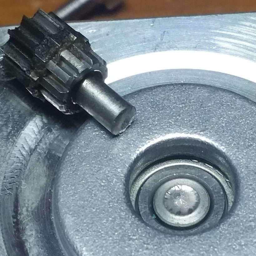

jimc wrote:how the stepper has enough torque to do that
A closer view of the shaft:
PcS - Broken M2 extruder motor shaft - detail.jpg (140.55 KiB) Viewed 6637 times
That dark spot on the motor end of the shaft (at about 10 o'clock) might show a flaw in the metal; it matches up with similar mark on the stub. The rest of the fractures look like what you'd get in case-hardened steel.
Given the bazillion snap-reverse cycles we ask of those poor motors, it's amazing they last as long as they do.
a production issue with kysan
Or whoever makes their shafts: that's a hot potato for the QC folks.
