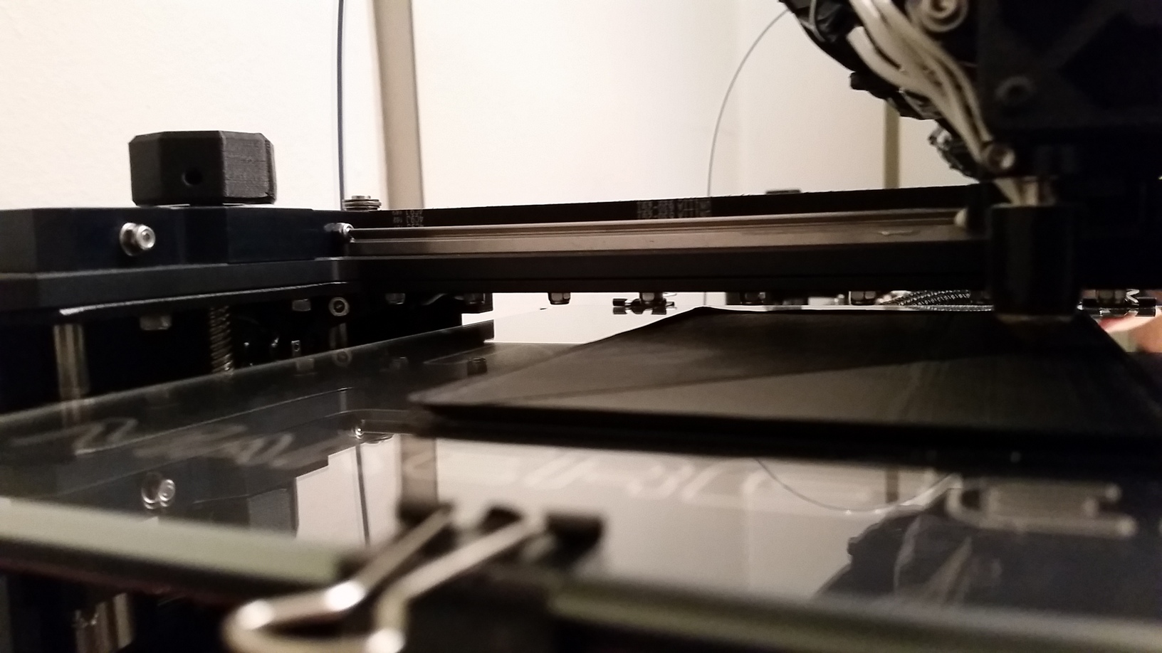

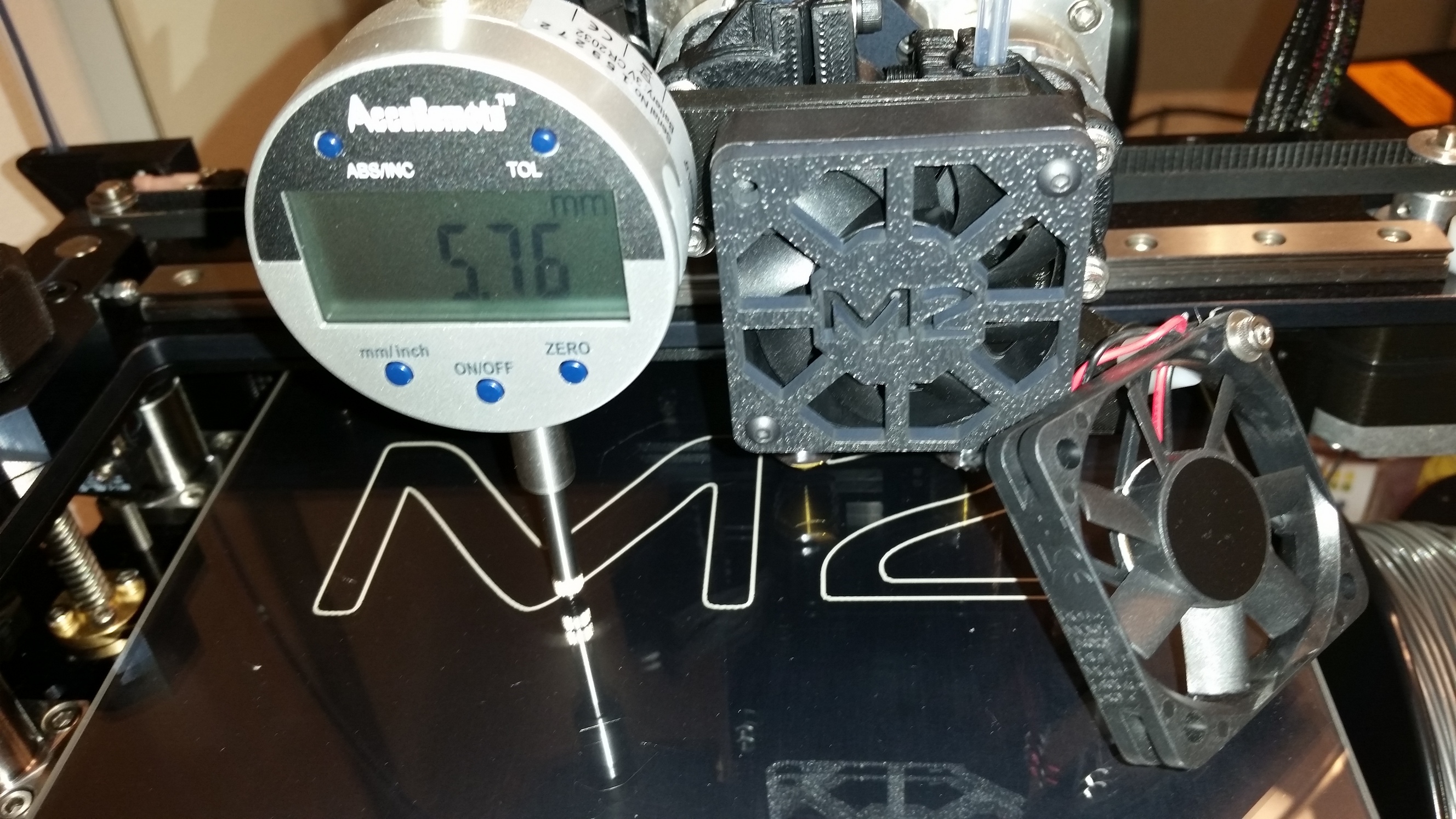

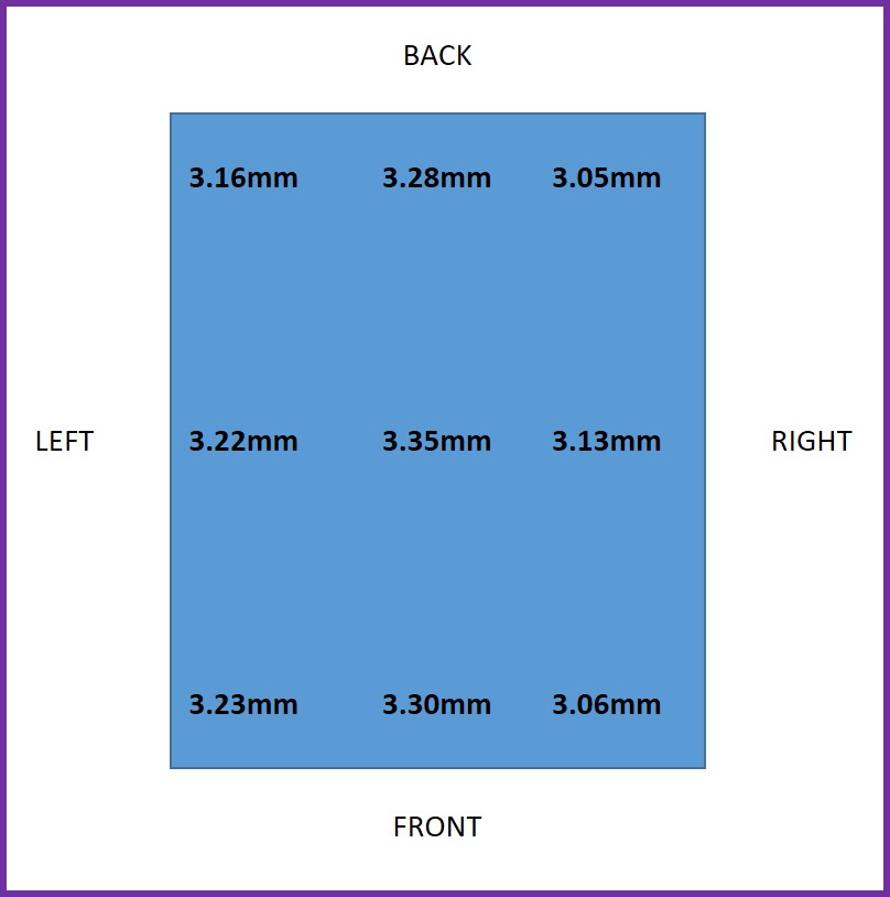

I printed up a simple dial indicator mount for the M2 Dual printer, attached a dial indicator and using the controls in Simplify3D I moved the bed around. Attached are a picture of how I placed the dial indicator and an image of the results on different points on the glass bed. I repeated this 3 or 4 times, starting at different points, moving in different directions and they all came out very similar. The result is that the dial indicator tip is tracing out a convex pattern with the high point in the center. I have dial indicator extensions, maybe another day I'll add some and repeat the measurement at different z heights to see if the z-axis is true. It's a bit late so not sure if I am missing something obvious about my dial indicator setup that could be the cause.
Likely causes:
* The left to center to right changes tells me that the x-axis rail bows down in the center since it's repeatable at all 3 x-axis measurement lines (except for the front-left corner). [This axis bowing is a major problem; short run but big changes]
* The front to center to back changes tells me that the y-axis rail bows up in the center since it's repeatable in all 3 y-axis measurement lines (except for the front-left corner). [This axis bowing is fairly minor; long run and minor changes]
* The front-left corner is odd. I had removed that paper clip from that corner but that shouldn't affect it's height; I placed the clip back for measuring purposes and it changed nothing but I haven't applied heat with the clip on. It could just be that the glass is extra thick in that corner.
Questions:
Has anyone here done a similar test with similar results?
Are the numbers I am getting typical?
Are the numbers I am getting acceptable by MakerGear standards (i.e. within expected limits)?
Print problems that will likely result (I haven't printed much yet):
On large width prints this basically means that I won't get first layer adhesion on the left and right sides when printing at .1mm layer height or even at .2mm layer height.
Solutions:
I guess I could loosen up the screws in the x-axis rail and slip some thin shims in the center then retighten the screws and see if that helps.
I know MakerGear employees read this forum, so let me know if I should send an email to tech support or if you have any recommendations.

- Dial indicator measurement results across the glass bed
- M2BedLevelingWDialIndicator.jpg (47.01 KiB) Viewed 17495 times
- Dial indicator setup
- (1.19 MiB) Downloaded 210 times

Yup, yup, dunno... [grin]LazMech wrote:Has anyone here done a similar test with similar results?
In round numbers, the stack of glass / heater / platform / adjustments should be flat and perpendicular to within about ±0.10 mm, but anything under that is difficult to maintain.
A year ago, an alignment ritual on my M2 took the (modified) platform alignment from ±0.5 to ±0.05:
http://softsolder.com/2014/07/16/m2-platform-leveling/
That seems to be quite stable, but I also treat the platform with exaggerated care: letting the platform cool causes the parts to pop off the hairsprayed glass without any prying and, because the (modified) platform glass is glued to the heater, it never comes off the M2.
On a stock M2, the interface between the heater and glass surfaces must be surgically clean, because a dirt particle or (shudder) hair between them will produce a bump. I wiped them clean with a low-lint cloth every time they came apart and, in general, I rarely took them apart.
The aluminum heater plate may be bent very slightly upward on the right corners; check for slight corner imperfections or burrs.
As it stands, the total range on your plate is 0.30 mm, with most of it within -0.10 of the middle. Tweak the Z offset (in your slicer) so the center is Z=+0.10, then the middle will be mashed by 0.10 and the far corners will be stretched by 0.20. That might be close enough to give good results, at least for 0.25 mm layers.
For thinner layers, tell the slicer to make the first layer 0.25 mm thick. That eliminates a huge amount of heartache and confusion: the thicker first layer soaks up all the misalignment.
Given your measurements, tighten the right-side adjusting screw by 1/12 turn (the wrench is a hexagon, so "half of a flat") to pull the right side down very slightly (0.5/12 = 0.04 mm at the screw) and re-measure the results. With a bit of luck, that will redistribute the offsets in your favor.
Use the software Z offset, rather than dinking with the mechanical Z stop screw, to make fine overall Z adjustments: you can't turn that big screw gently enough to converge on the right answer.
Because everything changes slightly when hot, I use the skirt around the parts to keep an eye on the alignment. After you set the basic alignment, the skirt thickness gives you enough information to tweak the screws without all the hassle of the dial indicator.
With a 0.25 mm layer thickness, this skirt measured 0.25±0.05 mm:
http://softsolder.com/2015/07/02/victor ... t-fixture/

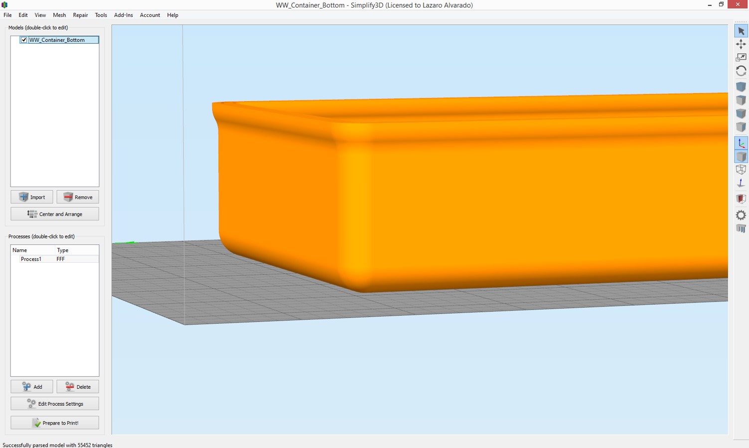

I wrote a really long post where I responded to everyone then I tried to attach an image and apparently I was automatically logged out and my response disappeared.
Long story short; I've leveled my bed as best I can considering the convex extruder-bed path; I'm printing a 4"x6"x3" box; the outer perimeter edges are curling/very wavy and I'm concerned that the print will fail. Attached are a picture showing the curling/wavy edges and an image of what I'm printing. I believe the edges have a 1/4" fillet. Would you guys expect such curling/waviness on the fillet overhang or is it more likely to do with the convex extruder-bed path? I could see how the convex shape would make the outer edge less well adhered which would compound to curling/waviness.
By the way ednisley (or whoever knows); do you use S3D? If so, how do you set the first layer thickness? Gotta add script? I see how to set the first layer height but that controls the squish not the thickness.

Re: Bed Leveling not possible on my printer?
Couple of things - one, that design does have a rounded bottom edge - part of the curling that you are seeing is no doubt due to that filet on the bottom. Second - are you printing PLA?
It is very difficult to keep PLA from curling on overhangs, and a fileted bottom edge is a prime candidate for that curling to happen, unless you print with support of some kind. (It's very difficult to print a perfect rounded bottom edge - even with support.)
But, having said that - if you are printing PLA - hit it with as much cooling as you can. Full fan, including a desk fan if you have one, pointed directly at the curling area (which is likely happening where the fan on the machine can't reach, like that rear left corner), and you'll reduce that curling. Very important to cool PLA quickly.
That has nothing to do with the level of the bed - your print looks like it's attached as well as can be expected, on the edges that can be seen in the photo. (If you see one of the edges start to pull up away from the bed, use hairspray or gluestick to make the print stick really thoroughly to the bed. Very critical to make sure the print stays firmly attached everywhere it is supposed to while printing.)
It will probably complete the print, but you might get a bit of a messy edge or side on that uncooled area.
