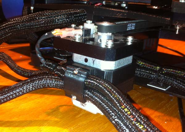

Thanks ED, I think you were right.
I cut the zip tie and took the motor off and plugged it into my other printer and it spun fine. Of course when I put it back on the original printer and now wiggling the wire everywhere I can't replicate the problem. But it's working at the moment so that's good. The portion of the heat shrink tubing around the wires where it was zip tied to the motor looks pretty kinked/worn so I''m guess that's where the problem might be. I think what I'm going to do is design a bracket that clamps to the motor and holds the wires a little more secure than the zip tie does.

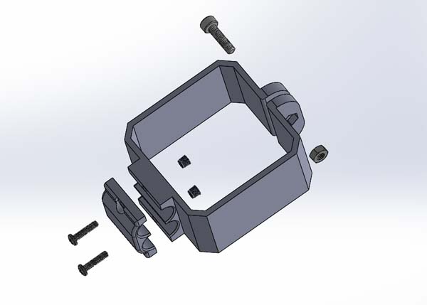

Post by sthone » Sat Jul 18, 2015 11:45 pm
Came up with this quick bracket, I'll have to see if it helps at all.

Post by jsc » Sun Jul 19, 2015 12:09 am
Nice. What are those threaded inserts that go in the inside on the left?
Re: Bad Stepper Motor?
Post by sthone » Sun Jul 19, 2015 12:22 am
Those are Brass Heat Set Insert for Plastics from McMaster-Carr they are pretty cool I use them on a lot of my projects.
