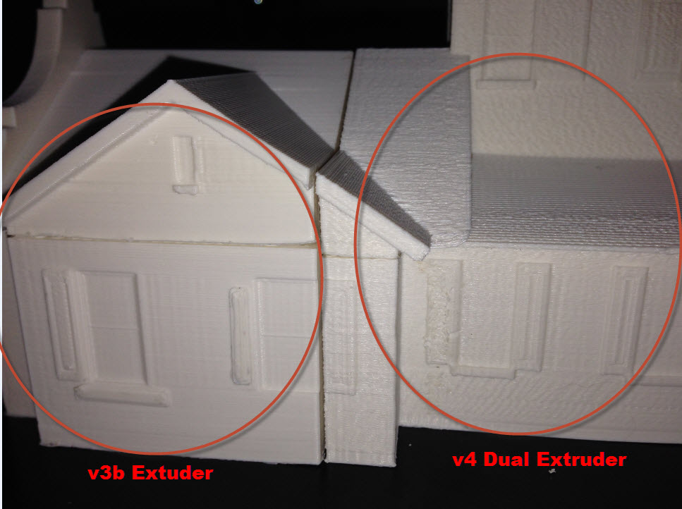

Hi All,
I recently upgraded my M2 to the Dual v4 Extruder setup. I'm only using the left nozzle at this time but i noticed a big difference is the print quality using the same Slic3r settings as i was with the older v3b extruder (see picture). I'm fairly certain the bed is properly leveled but i'm not sure what else could be the cause. :shock: Any help would be greatly appreciated.
Print Quality (v3b vs v4 dual)
Print Quality.jpg (102.26 KiB) Viewed 13455 times

More details on what you have done for calibration?
adjusted your multiplier?
Z-Offset adjusted?

Should i reduce the multiplier or increase it? i think it was set to 1.0 in this photo but I was thinking about changing it to 0.95. The z offset is set to 2mm but should i decrease it to 1mm?

there's no "doctors orders" on how to set those, its a process that is described well in this calibration thread:
viewtopic.php?f=3&t=1964

Yes its a totally different hot end setup. Your v3b settings wont work. Everything needs to be retuned for the v4.

Temps are different between the two aren't they ? Seems like some people had to change printing temperatures slightly. My v4 I run pla at 180 . On the v3b it was 210.
