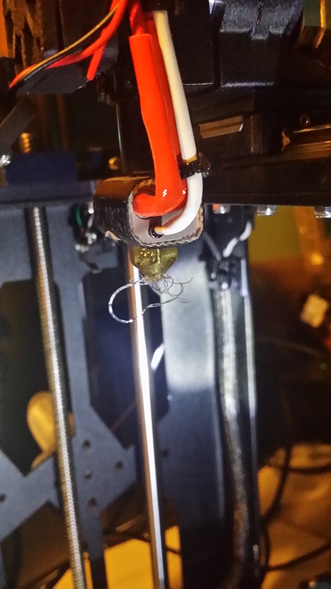

I started using Rsilvers PLA FFF in S3d and it worked perfectly. I went through probably 5 or 6 prints with no issues. Yesterday I was out of town so I didn't use my printer at all; today I go to start a hemisphere piece (of which I already printed one with no issue) and it starts stringing slightly; the purge off the side of the plate keeps noodling up around the extruder. Once it gets on to the part it starts the first layer it tends to keep a tendril attached to the extruder and in general isn't as clean a print as it was. The biggest issue is when it get to the support it starts ripping it up and gumming itself down in pla.

If PLA is "noodling up" like that, sounds like you may have a bit of baked-in plastic partially blocking the nozzle. This is not necessarily causing the print failure, but it's a good candidate. Various solutions to this can be found on the forum. One simple method (after retracting the filament a bit) is to poke a wire up into the nozzle and work it around to get rid of the blockage. That only works if you have a good piece of wire about 0.3mm (I have a 0.3mm lead mechanical pencil and found that the little needle that they give you to clear out jams in the pencil works perfectly for the printer nozzle). If you have nylon filament or cleaning filament (I think that's exclusively from eSUN), that can also help get a clog out. Running your extruder up to high temperature (250 C max if it's a V3b, higher if it's a V4), you can potentially burn any PLA residue into ash. You can also remove the nozzle and do the same thing with a butane torch, although anything that requires removing the nozzle is more involved. Soaking the nozzle (preferably outside the house) for a while in a paint stripper containing methylene choride should dissolve the PLA residue, but hitting it with a blow torch is a lot simpler.

That noodling in your photo is something that I always see while the nozzle is heating up, there is always a little bit of leftover plastic in the nozzle from the previous print that oozes out - if you let it heat long enough, the little plug melts and the whole wad falls down. (Or you can reach over and grab it with your tweezers - usually the easiest.) Or you can extrude a few mm through once it is hot using the jog controls, and let it clean itself out. The noodling at the side of the bed during the purge is also normal, i grab it with the tweezers and gently let the weight of the purge pull it down to the side of the plate, instead of letting the wipe smear it across the bed. Keeps things a lot neater, and it only takes a second.
I also always run a skirt of 2 or three threads around the part to prime the flow, and get rid of any leftover globs that i might have missed with the tweezer pluck.
