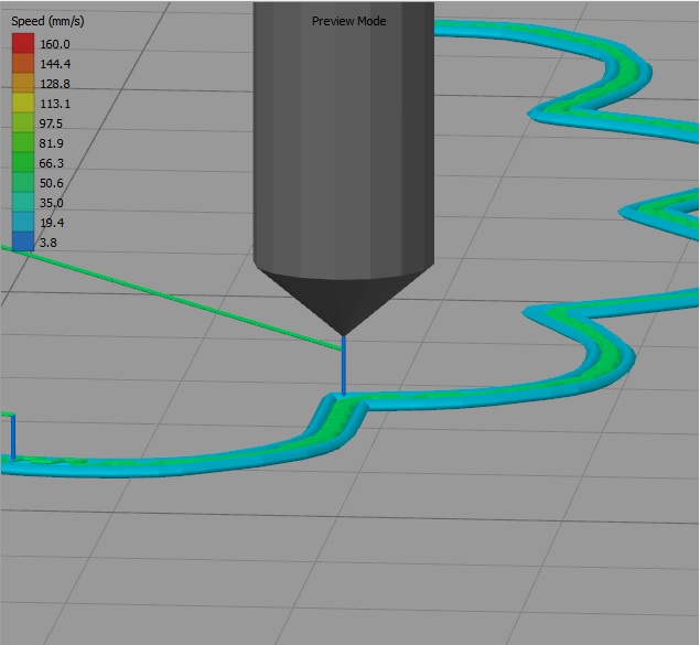

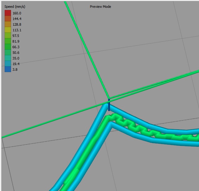

Here's the two points, in my test, that seem to produce, by far, the most noticeable threading.
Interesting that one is at the beginning of the layer, and the other appears to be be coming in and then immediately taking off. I haven't seen the G-code, but I'd imagine that both of these points involving "unretracting" and then immediately "retracting" right before lifting off - the extruder unretracts right at the start of the layer, and it also unretracts as soon as it lands right before taking off again. Maybe the extruder motor can't work fast enough to retract effectively under those circumstances? (Or perhaps the nozzle design doesn't allow for effective retraction under those circumstances? Unretracting at 40mm/s and then immediately retracting at 40mm/s before traveling.)
It's clear it's pushing out 1mm of filament during "unretraction" immediately before retracting 1mm of filament and traveling. This 1mm "unretraction" appears responsible for the blob I'm seeing that gets dragged across creating the prominent thread. All the other travel points lack the "1mm unretraction", going straight from laying down infill to retracting 1mm and then traveling across. All the other travel points also appear to coast 2.8mm right before retracting 1mm and traveling, whereas these trouble points don't have coasting present right before retracting 1mm and traveling.
After thinking about it, I'm surmising that the 1mm of filament has the forward momentum from the 40mm/s unretraction that can't be effectively reversed during the 40mm/s retraction, so it ends up creating a blob that gets threaded across. One way to reduce the momentum, reduce retraction speed - less speed - less momentum. I'll try 10mm/s. (My makerbot has a retraction speed of 20mm/s, so that's noteworthy.)

Your model with the trouble spots is getting that dotting behavior because there's a tiny empty spot that it feels needs to be filled. Try using more than one perimeter.
Also, I highly recommend trying burning off the hairs with a lighter....
Retraction speed should be as high as possible, to relieve nozzle pressure quickly. Or so I've always been told. That extrusion speed quoted is probably sustained extrusion speed, and not an instantaneous limit.

Oh, thanks for the insight! The "tiny area" isn't visible on the S3D screen (I'm guessing it doesn't draw tiny deposits of filament?), but I can see what's happening. Anyway, I've found a solution though it's a bit of band-aid more than anything. I changed the extrusion width of my M2 to match my other printer's nozzle, which is .4mm, which had the effect of reducing the infill channel's width and presumably helps eliminate those "tiny empty areas in the corners" (My previous testing showed that if there wasn't /enough/ infill, it doesn't create hairs...) and, yep, it's working. No hairs and tiny little tumors, now. This only works because my models are specifically designed for my other printer (The wall thickness is designed to match the nozzle's width so that it's roughly two filament lines thick.).jsc wrote:Your model with the trouble spots is getting that dotting behavior because there's a tiny empty spot that it feels needs to be filled. Try using more than one perimeter.
Doesn't really solve the situation in the case where the walls are just a /little/ thicker, but that shouldn't be a problem for me since I control the wall width for the most part.
So, situation that causes hairs ->
Infill channel is wide enough -> Tiny empty areas in the corners are created -> Extruder deposits a tiny bit of filament, but instead of getting laid down on the model, it creates a blob that then... -> Extruder retracts and drags the blob across model creating hair/threads and tiny tumors.
Eliminate the tiny empty areas by reducing the infill channel width (By increasing extrusion width) resolved this for me. Be nice, however, if there was a more direct way to control this in S3D - as in, "Don't lay down anything below .9 mm^2."; i.e., don't try to uselessly fill the tiny empty areas which you don't fill, anyway.
