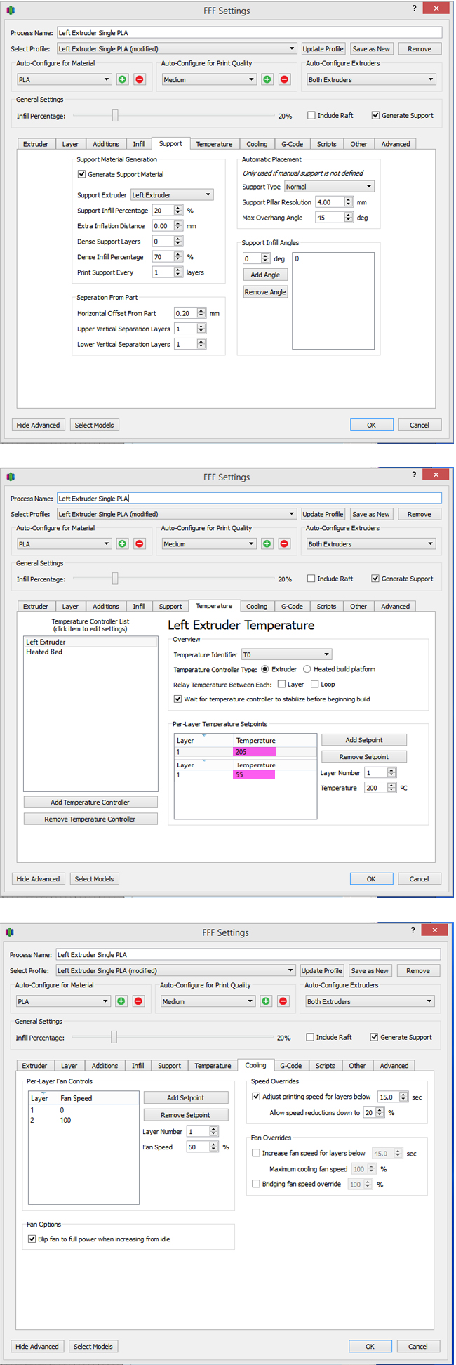

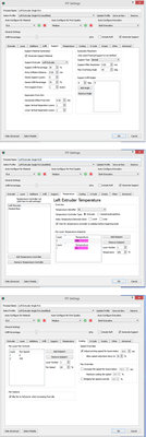

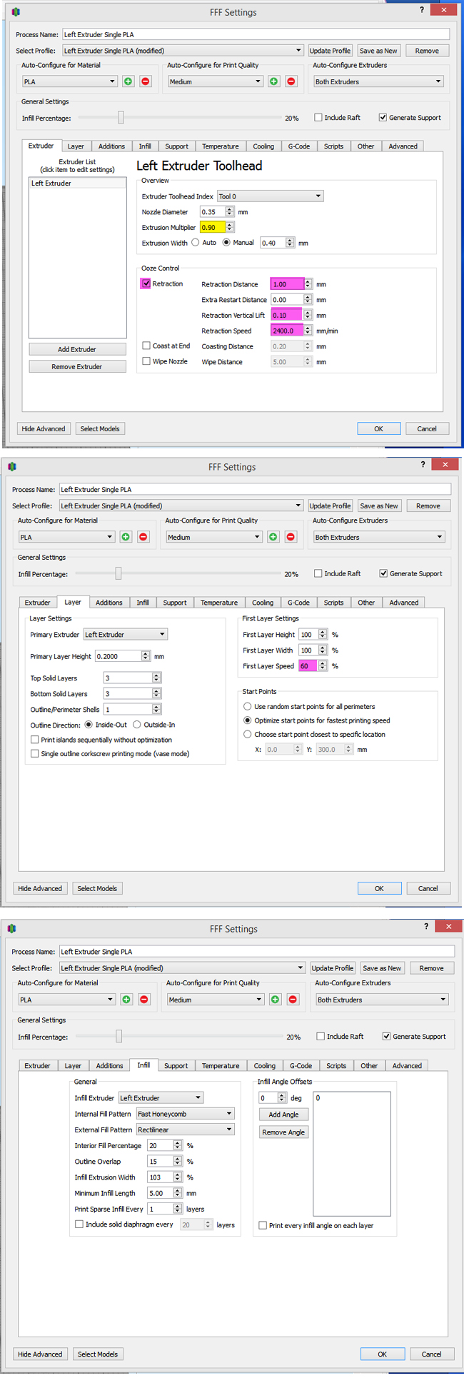

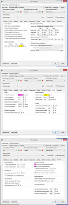

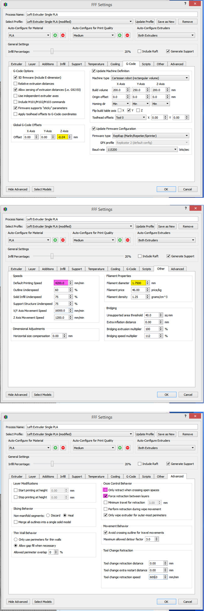

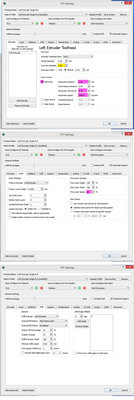

Ryan, here's what you need to do if you just got an M2:
Read the How To: Guide to Getting Started at the top of the Getting Started section. It will save you days of frustration.
And assuming you have Simplify 3D, give the settings below a try for PLA:
You will need to change the settings highlighted in yellow to match the settings that you determined were correct based on your calibrations, from the Getting Started Guide.
Other spots that need to match are highlighted in pink (for the starting zits).
