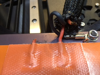

anyone run into this on their M2 ?
heated bed fail.JPG (37.12 KiB) Viewed 16880 times
It's obvious why it's not working, Cant figure out how this happened :shock:

Its broken by mechanical stress. To much bending. In my eyes this is the best solution: http://www.thingiverse.com/thing:1001793
In the meantime just remove the complete sleeve and replace the wires.

Yes, the wire experienced fatigue stresses and eventually failed over time from the back and forth motion. I think this is a fairly common problem - mine did the same thing a month or so ago.
You could print something, but I think my solution was better...I contacted MakerGear about getting/buying a replacement and they sent me one. The new one I received has a stronger wire design which eliminates this problem.
In the meantime, you can attempt to solder it back together (if you have the tools) or do something else along those lines like Kulturfolger said. Also zip tie the wire to the metal spider piece to reduce stresses.

SouthSideofdaSky wrote:Yes, the wire experienced fatigue stresses and eventually failed over time from the back and forth motion. I think this is a fairly common problem - mine did the same thing a month or so ago.
viewtopic.php?f=7&t=1712
I wound up soldering it back together, the weird thing is I can't find the "Heated Platform" as a spare part to buy...... :o

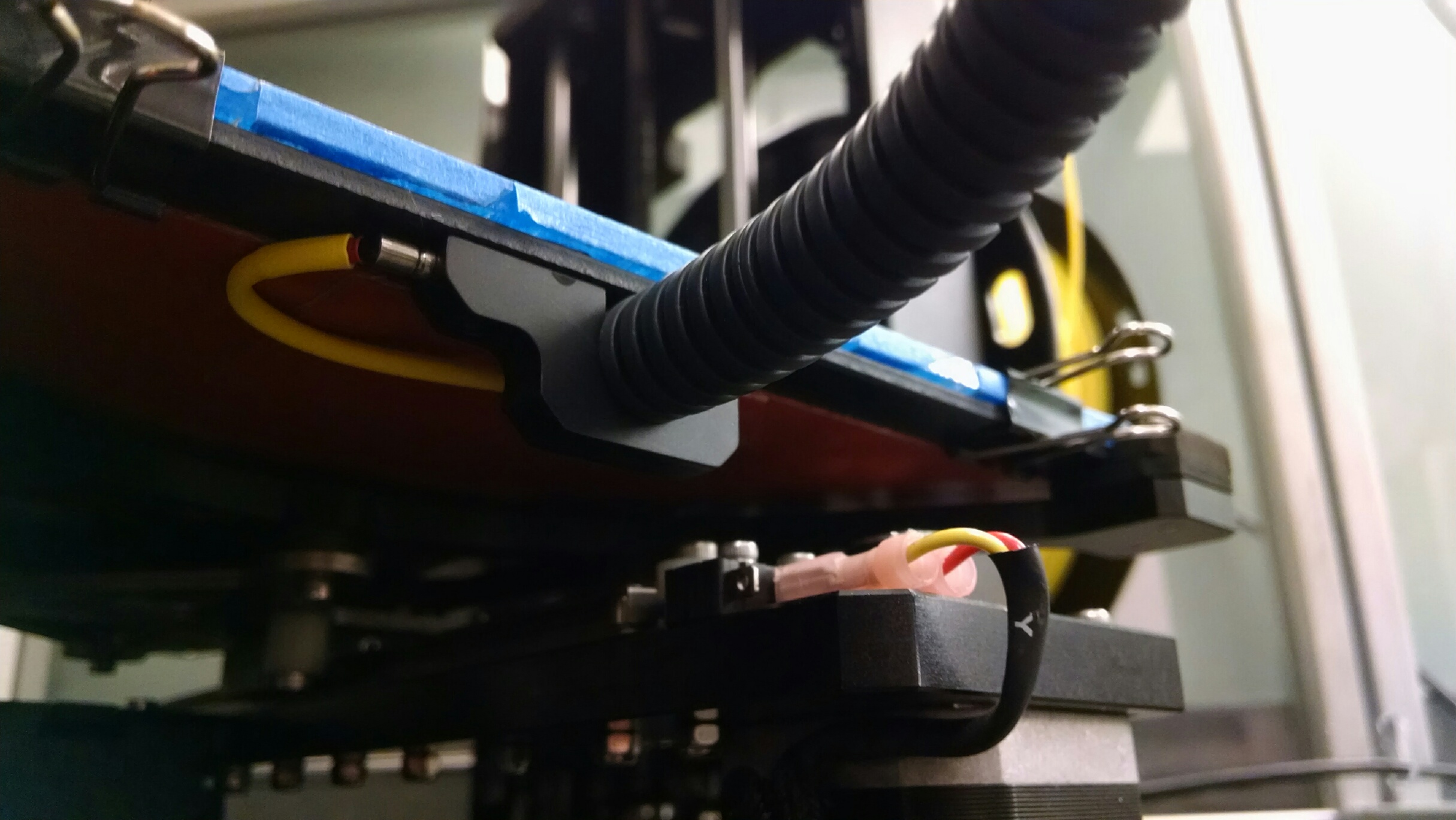

What does the new style look like?

I just looked the new style has a loop/circle at the end of the bed, the cable which is inside a wire loop goes thru the hole. Essentially supporting the wire, much better design.
I would think it could be added to any bed, they just drilled two holes in the bed, countersunk, and attached the "loop" on the bottom.

Picture?

Here is a picture of what the new connection/wire design looks like (sorry, was in mid-print yesterday :D )
New HBP design
