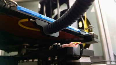

I just looked the new style has a loop/circle at the end of the bed, the cable which is inside a wire loop goes thru the hole. Essentially supporting the wire, much better design.
I would think it could be added to any bed, they just drilled two holes in the bed, countersunk, and attached the "loop" on the bottom.

Picture?

Here is a picture of what the new connection/wire design looks like (sorry, was in mid-print yesterday :D )
New HBP design
