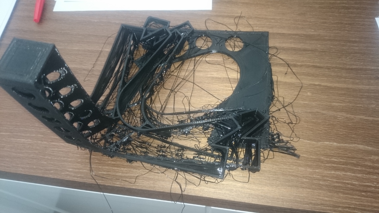

As you can see from the pictures something went horribly wrong. The bottom moved right around, like 180 degrees and the other layers...well they shifted all over the place.
I am new to 3D printing and I have printed a handful of things before without issues and I changed a couple of settings from what I have read on here. I should also add my engineer hasn't designed parts for 3D printing before and he is sending me these practice or calibration parts to test with to check the shrinkage value and whatnot.
I'm printing in PLA, I changed layer 1 to 60 degrees and layer 2 to 70 and I had the extruder at 220
I have read and made some changes in accordance with this help guide from S3D https://www.simplify3d.com/support/prin ... leshooting

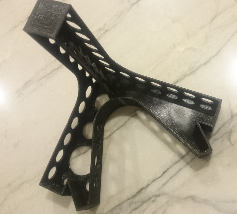

It's printing again now after the changes which include the blue tape to the bed and leveling it out and taking my time this time to get it right. I changed the layer hright from 0.30mm to 0.28mm. Layer 1 is back to 70 and sticking with 220 on the extruder.

looks like it released from the bed mid print

220 is more on the highend for PLA.
205 has been working well for me, with 55 degree bed, on glass with hairspray. Works very well.
Print a calibration block, from that get your Z-Offset, and your extrusion multiplier.
PLA has very little shrinkage, essentially none.
The M2 does great at .2mm layer heights.

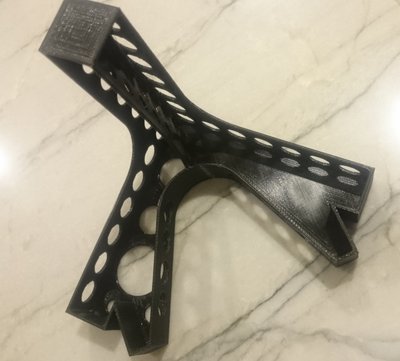

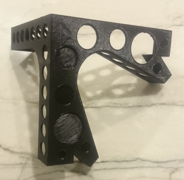

The pictures show that the model printed ok however there is a layer on top of the holes which isn't supposed to be there.
I have attached the model and you will see that the layer on top of the holes isn't there but when you preview the print it is there. I am not sure what's going on with that.

I downloaded it, and when I do the preview I can see that on the one side, the holes are filled in, so it would print just like the one you have printed out.
I can't answer why that happens, it has to be the model. Someone who knows models better would know the answer.

Welcome to the Simplify 3D bug. The new version creates bridges over holes for some reason. I have had success passing the model through Netfabb online STL processing available free from Microsoft. No matter how well they are built, I get the same bridging errors. Old models that ran fine have issues when processed with S3d version 3.
Your second print looks pretty good. For my settings, I print my first layer at 215 and others layers at 210 on to a blue taped bed at 50°. 90% of my prints are at .20mm layer height, others are at .25 for a faster print. I have run a few prints at .10-.15, but unless the detail level is very high and the print relatively small, you get diminishing returns for the time required.
It could be that your .30mm print height caused the first print to fail. The nozzle is .32 so you don't get the "squish" you need for good layer adhesion. If your machine is under-extruding, due to settings or a clog, it will definitely cause delamination. As you get more used to tweaking the settings, such as the extrusion multiplier, you can compensate a bit by over-extruding to get the layers to stick together.

willnewton wrote:Welcome to the Simplify 3D bug. The new version creates bridges over holes for some reason.
Grrrr, yeah, it nails me every time i try to slice something where the edges of the hole have been filleted. :|

This is a thread on the S3D forum with another person having bridging issues. He able to rotate the model to "fix" the bridging, but it is not oriented correctly for printing. I was able to change the layer height on my print from .20mm to .25mm and it "fixed" the problem as well.
Although, it's not really fixed. ;)
https://forum.simplify3d.com/viewtopic.php?f=9&t=3852
Re: job went sideways and 180 degrees
Post by jsc » Thu Nov 12, 2015 3:59 am
I think this is a long standing bug, actually. Jump to the Nits and Bugs section of my old writeup: http://jinschoi.github.io/simplify3d-docs/
Simplest fix is to tweak your first layer height, try 99% or 101%.
