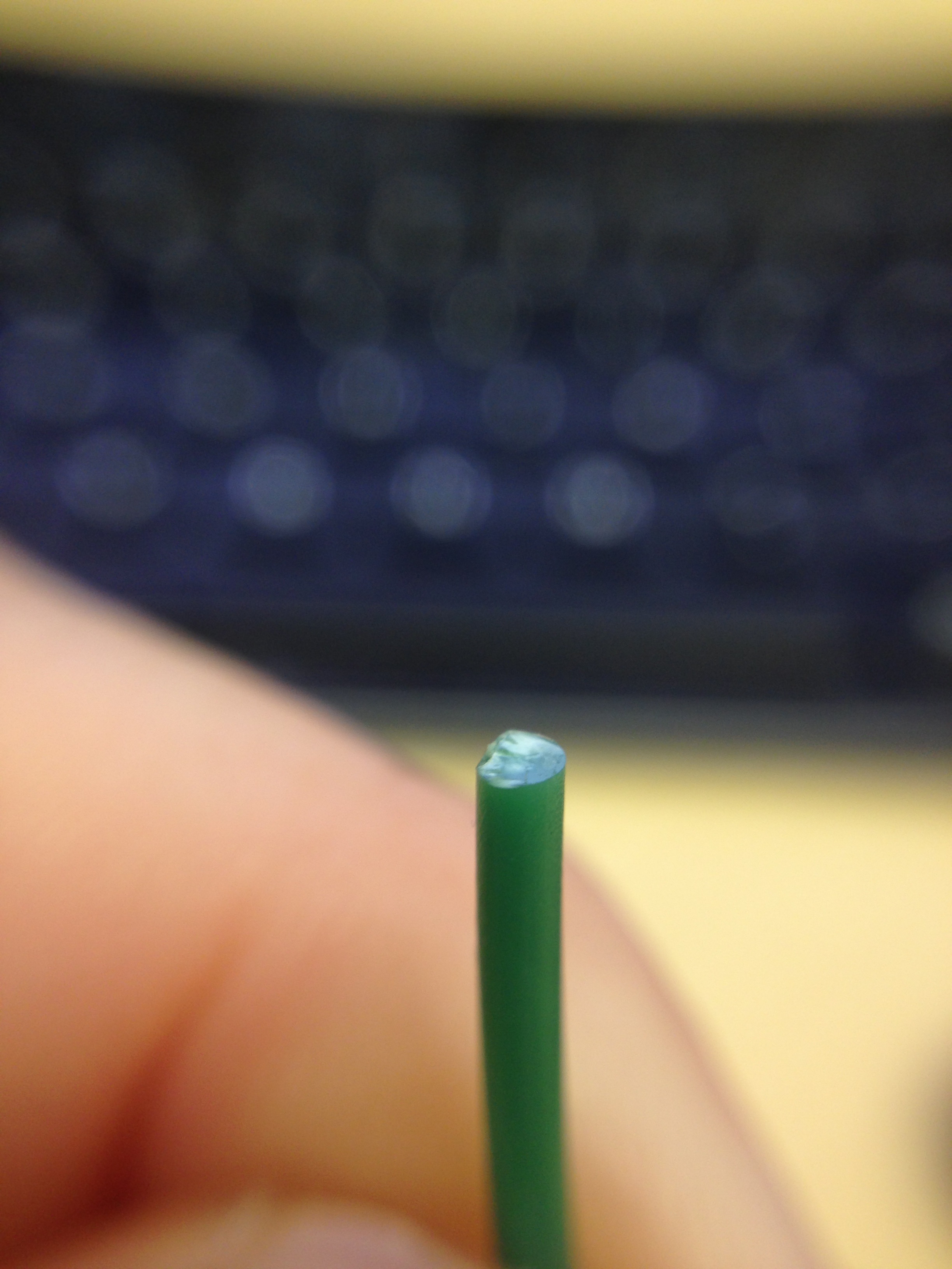

Has anyone had this happen to them? I've been trying out eSun's PLA and had the filament snap before the extruder gear. I cannot tell for sure exactly when this happened, as I was printing remotely, while an assistant cleared the prints of the bed. I had him take the last print off the bed, and I started a new print, only to find out that nothing was being layed down. While on the phone, turns out, the filament tube was dangling in the air. The spool wasn't stuck or anything, and the previous print seemed to have printed fine. I re fed the filament in, and got right back to production, no nozzle jam or extruder jam. The part that snapped, looked real clean with no extruder bite marks. Really bizarre, maybe a defective spot in the filament? Still though, would have taken quite a bit of force to snap a filament, and I think the gear would have stripped the filament before it snapped. Tension is good. What would cause this?

Yep! Seen it happen twice - once with a spool fresh out of the package. It's caused by the filament absorbing too much moisture. It gets brittle over time. (And apparently sometimes during manufacture - might have been a rainy week or something.)
Recently had it happen with an old roll that i left out in the air for too long too. If you put it in an airtight container with some sort of dessicant package and leave it there for a while (like a couple weeks) it regains enough flexibility to use it without any problems.

This was a fresh spool too, and I thought it was moisture, but I tried to snap it a few inches near by, and it just bent. Maybe a drop or liquid or someone's spit landed on that spot of the filament?

So I just had the same spool break on me again. sigh, so frustrating. This time, it snapped above the extruder gear, AND there was a partial break inside the filament tube. Leads me to believe the breaks are already there? Pretty sure it isn't moisture absorbed as every other section prints fine, its about a week old, and inside an environment controlled room 60% humidity (its inside my datacenter right now...
I'm tempted to unravel the entire spool to see what it looks like. I know eSun makes decent PETG, just never heard much about their PLA. Maybe I got a dud?
