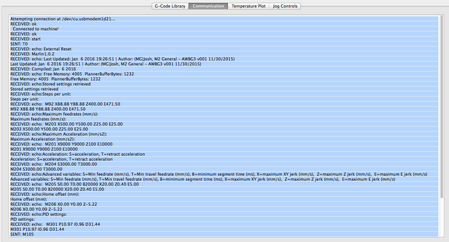

I've attached the opening communication before doing anything, then after it locks up. It doesn't give an error message, it just stops communicating altogether. I don't know if has anything to do with the new leveling system changes or if my board has given up the ghost, but since Quick Start was working fine all week, I'm worried it's the latter. I thought I'd start here before emailing support in case I'm overlooking something obvious.
