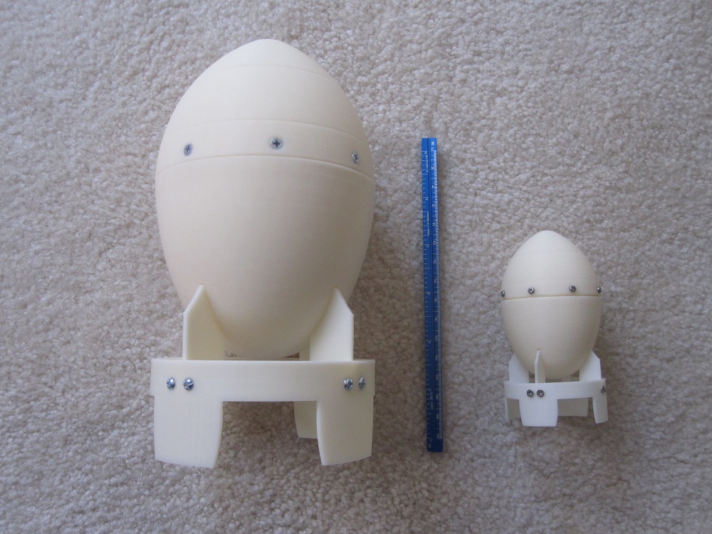

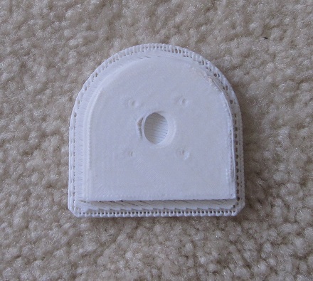

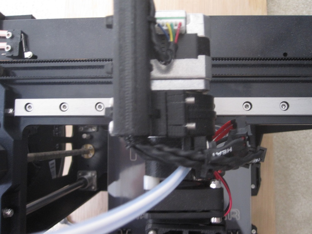

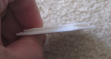

I've been doing a lot of ABS printing recently (see pic ) and have been very happy with the results. However, just today, I can't seem to be able to print a part (motor mount for a flying towel plane) that I have printed successfully 3-4 times previous. The print starts ok (there are some "squiggles" in some of the raft lines I don't normally see), but about an 1/8" or so into the print, I seem to get an XY shift in the print and I have to abort (see pics ). When I looked at the print head, it was not very tight in the holder and could rotate w/o much force being applied. I assume it should be a tight fit, correct (at least so I cannot rotate the head by hand)? So I went to tighten the fit and there are cracks in the printed holder (see pic ). I assume I need a replacement part, correct? How do I go about that? Is there any way I can keep printing in the meantime (I'm in a bit of a time crunch with this one)?

Mine did that too after accidentally colliding with one of the binder clips. I used a couple of zip ties to cinch it down so I could print a new one, but you have to really pull them tight with pliers. It worked long enough to print two new mounts and was still tight when I replaced it.
Re: Crack in extruder motor holder
Yes, just do whatever you can to remedy the situation long enough to make another one. Epoxy should work, too.

I've super glued some of the plastic bits back together and it's worked just long enough to print new pieces but if you want a more permanent fix I'd recommend the Metal Extruder Mount Upgrade I just put them on both my printers and they are rock solid now.
