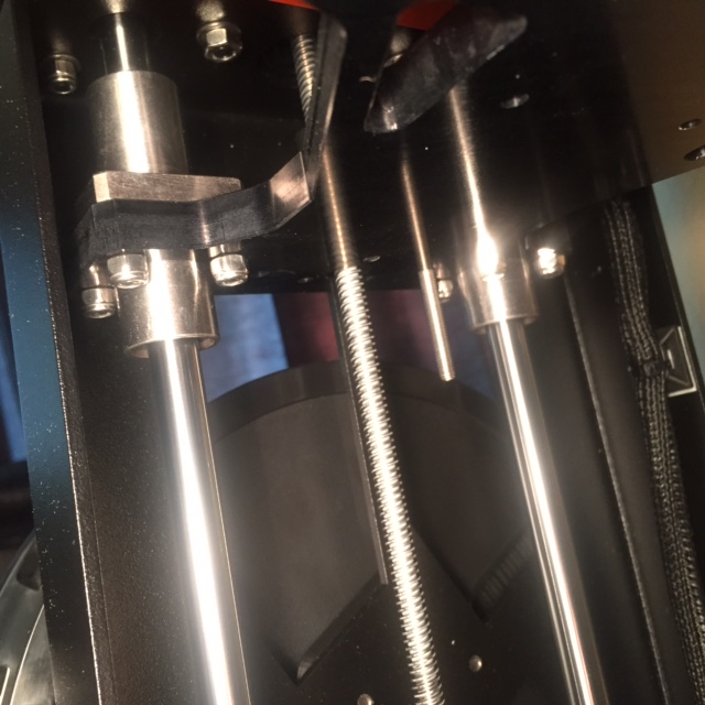

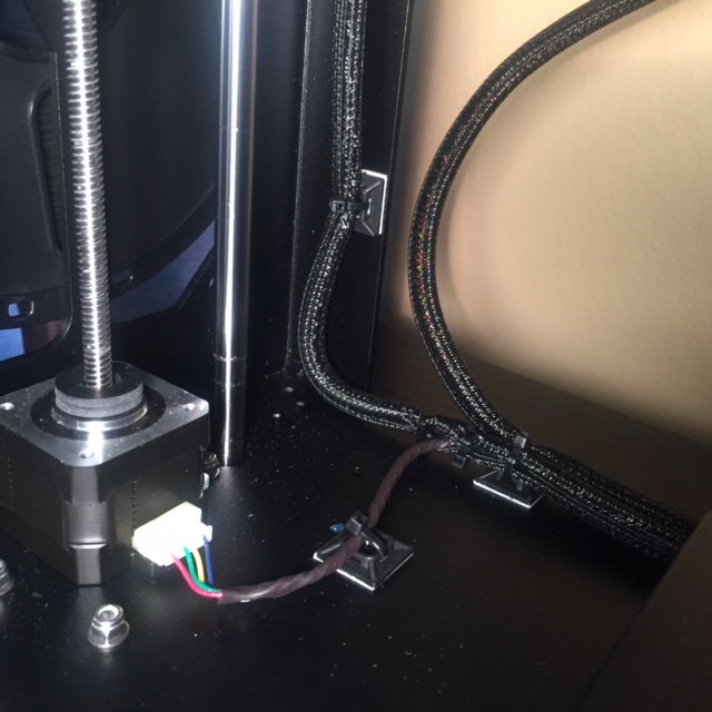

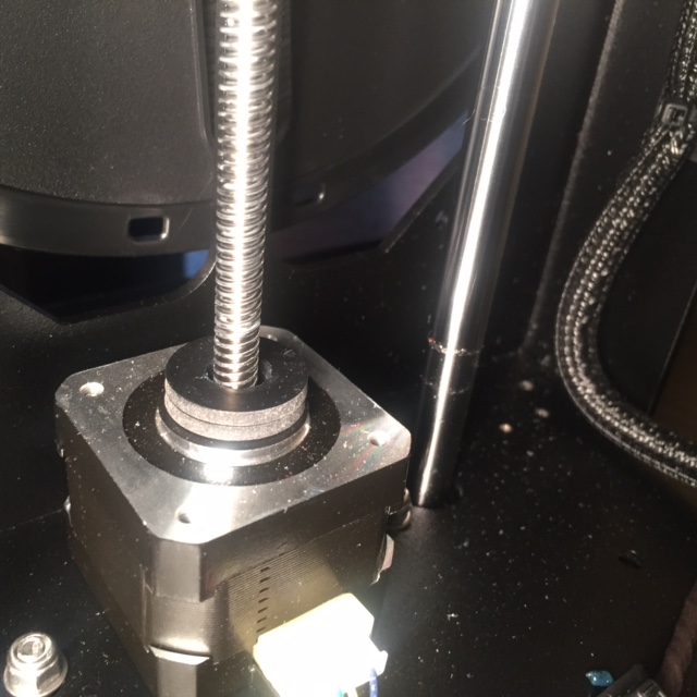

Can you take some pictures of the top and bottom of the threaded rod that lifts the bed? I'm looking for near the motor down below (where there might be a switch) or on the underside of the top (where there might be a switch). Please post them as attachments.

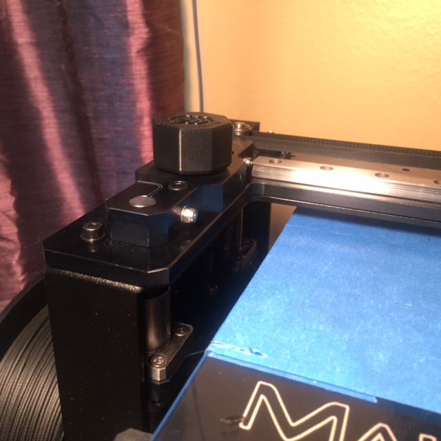

Here are the pictures I just took. To be clear, I'm looking for whatever knob/screw/whatever it is I need to turn in order to set the highest point the bed will go.

Here's a quick link to the User Manual the z-stop bolt is shown on page 4 and it's #14.
Here's the link on how to set it.

If that's the case - how the heck do you access it while the bed is raised..??sthone wrote:Here's a quick link to the User Manual the z-stop bolt is #14

You move the jam nut to the underside of the sled

craftzero wrote:If that's the case - how the heck do you access it while the bed is raised..??sthone wrote:Here's a quick link to the User Manual the z-stop bolt is #14
Works pretty well, but you have to take the spool of filament off to get to it, if you already loaded it. (Retract filament completely, then remove.)

I finally found it, and I adjusted the Z stop to where it should be.
