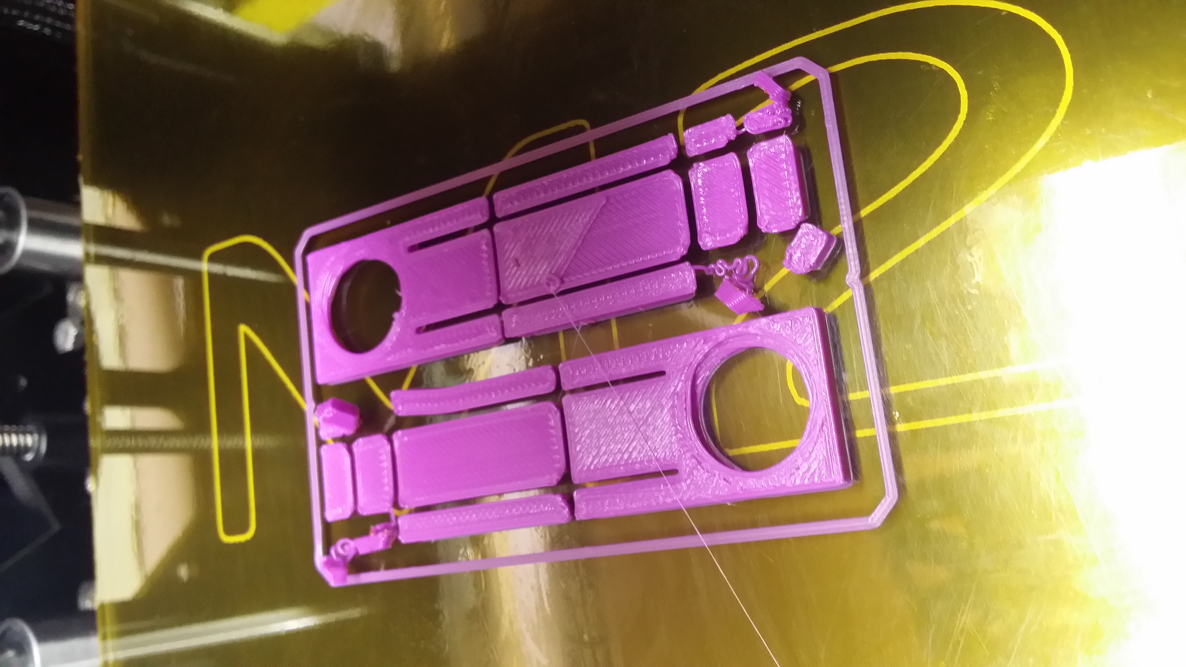

I guess really what im after is a good baselilne. Some prints come out fine. Others, get wrecked during the print. Mostly when dealing with threads or small parts. For instance thing:21357 is a pcb vise.
The 2 arms that hold the board have 4 very small parts (about 1mm X 2 or 2.5mm) on the first 10 to 20 layers. Ive done about 6 prints of this and they keep coming loose.
My calibrations of both the square and the thinwall cube are in spec.
I've dropped the speed to 40mm/s with 100% infill in hopes that may help, but im swinging blind.

Nope. that failed too as i was typing my reply to you.
Sometimes i don't feel like i can take my eye off of it.

I used your .26 profile with the same results.
I did have a clog last week. I cleared it and reset tension at the same time.
I'm not looking at it now, but i think your brim is set to 1 layer 0 offset and 6 outlines. 6 may be a bit much for that piece. i may try reducing it by 2 or 3 and see what happens.
I also noticed that you dont have it writing anything to firmware. Previously i did. Should i do another reset of the settings?
