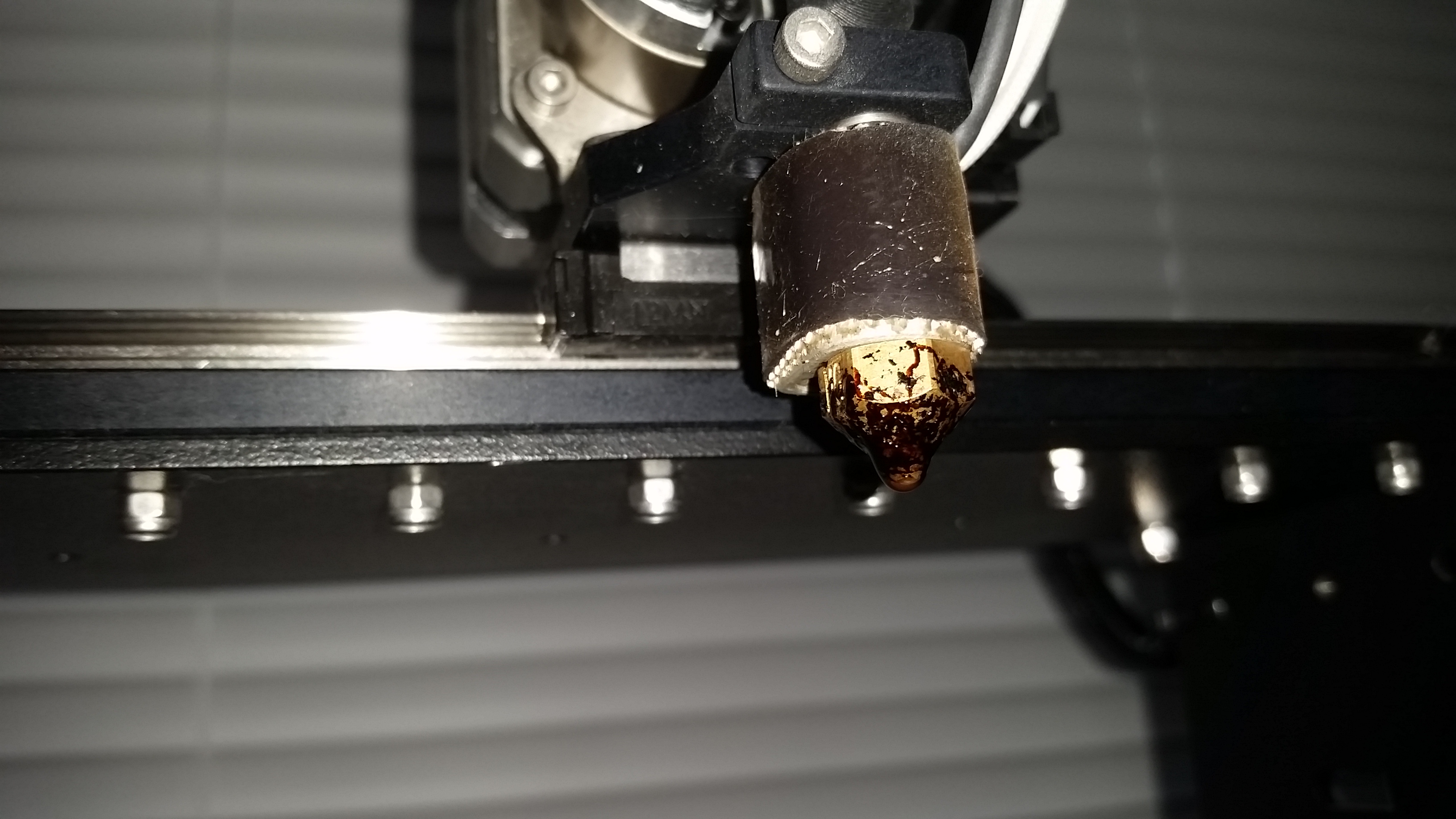

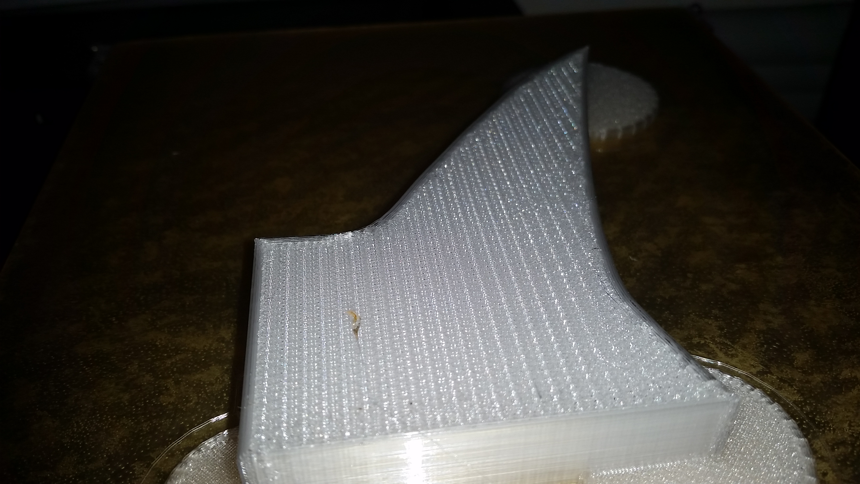

Happened again despite raising temps to 255. Got about 25% through the print before jamming. Including some pictures. No lifting had occurred on the print. The retracted filament looks all kinked up, and the filament at the tip had turned an opaque white.

Re: First time issue; esun natural PETG clogging extruder
Try 53 mm/s. (And check your filament drive screw tension.)
yeah im with jules. check your tension isnt too tight. you could be squishing that into a oval shape making it tight in the filament path.
