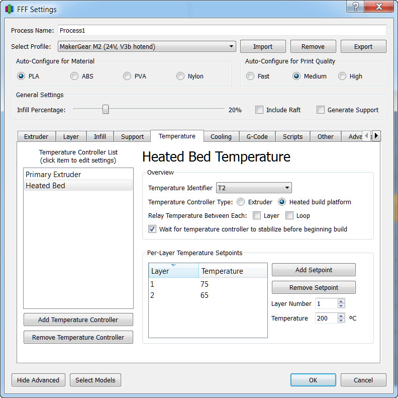

- Other info: PLA 1.75mm (makergear), Bed: 75 1st layer/65 2nd layer, Extruder: 215
- Temp layer settings in latest ver of S3D:
1st layer vs 2nd layer temp settings

well the idea is that the plastic is hotter for first layer to help it stick to the build plate better then you can cool it down a bit. just what you doing there in your process is pretty normal. alot of people seem to do it and there is really nothing wrong with that. your problem in the video is that your printing waaay too far from the bed. your z-height adjustment is to big. you need to adjust the stop bolt to bring the bed closer to the nozzle. some people use paper or a business card for the spacing. i use a feeler gauge and set the gap to .005". yes general discussion would probably been the place to put this but i think that ok.

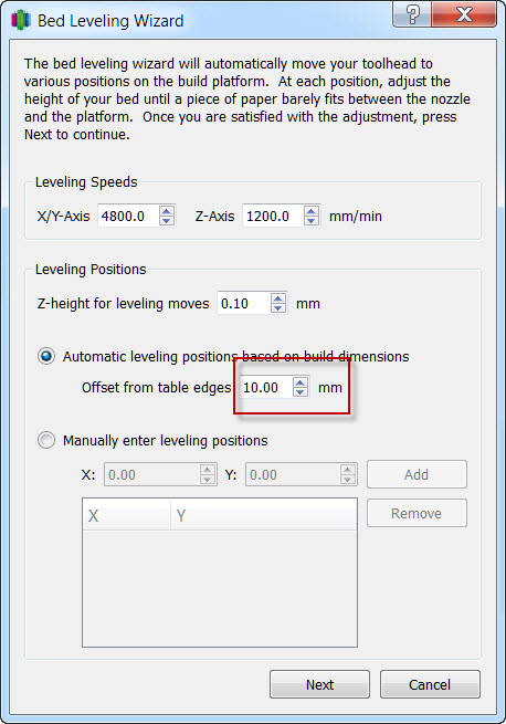

Thanks Jim - yes I can see now that gap is way bigger than a biz card/paper altho I will use feeler gauges to get it precise. Aside from the fact that I'm afraid to touch the machine, I mistakenly thought SD3 would do it all for me with the bed-leveling wizard with this setting:
I will use the manual: "Bed Leveling and Z-height Adjustment Methods" here from Toby: viewtopic.php?f=3&t=12
ps - thnx for heads up on forum cat posting - probably got a few more silly Q's to go until I get up and running so I will post in general discussions ;)
