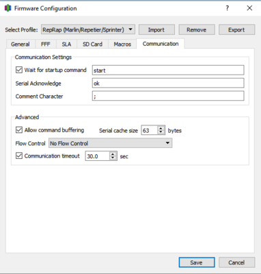

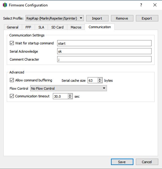

Hey Jim,
I'm not sure I see the setting you are talking about...I've attached a screenshot...Maybe you meant Flow Control->Hardware Flow Control from the drop down?
I'll also check for updates on my Windows machine....If this print completes,however, I'll likely just pull the USB cable for long prints from now on. Waiting 24+ hours and it suddenly failing is not fun!
Re: Print stops (incomplete) after 20+ hrs...need help
Thats because your not running the latest s3d version. Check for updates button never works
You were correct..I have 3.1.0 on my machine installed, but I pin the launcher to my taskbar and when you install an update they never really upgrade, but install it side-by-side...So my taskbar launcher was launching the old version...
So there is no way for me to know which was running when the print failed....but I guess that doesn't matter since the options were never selected!!
Anyway, my print is still running with the USB cable removed...I"m hoping it completes this time!
