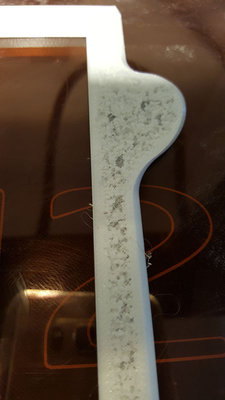

This is a frustrating problem I've started having recently when printing with PETG. I call it "infill rot," because once it starts it grows on each successive layer and has the appearance of termites eating the inside fill area. Once started, the print usually can not recover from this because it creates a rough surface that sticks up into the next layer and makes each successive layer worse than the last. The nozzle starts accumulating an excessive amount of blobs once this starts too. It's just a chain reaction that does not end well, and it can spring up out of nowhere on a print that has been going fine for several hours. I've even tried to recover a print in process by sanding down the rough surface in hopes that the next layer will be able to pave over the mess, but this has never worked. Once it starts, you might as well just cancel the print job because it will eventually self destruct.
The example here is e-sun PETG being printed at 255 temp, 4000 speed and 80% infill. I suspect the problem only happens on partial infills, as all my previous PETG work has been 100% infill and I've never seen this problem. At 80% I see it every single time though. I've tried different extruder temps and print speeds but just can't seem to eradicate it.

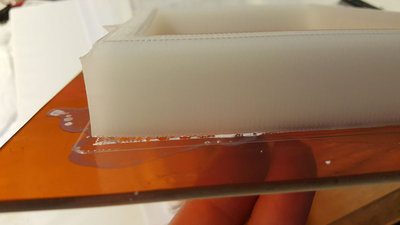

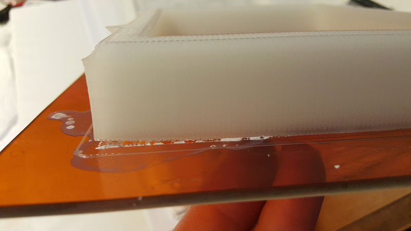

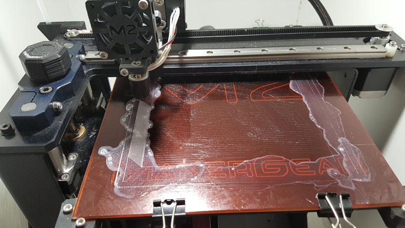

What I like about ABS slurry is you can control how sticky it is by the % of abs or the thickness of the layer you apply. There's the "nuclear option" where you squirt the abs juice on a hot plate where you know the perimeter will be and then you don't wipe it off. You just let it evaporate into a thick abs layer that acts like a brim and really grips the plate (see image below). You don't want to use that unless you absolutely have to though because the part is really hard to get off even even putting the plate in the freezer, then you have to wash the plate in acetone to get the mess off of it. But that nuclear option will beat PEI and rafts for holding the part down. The only thing stronger would be putting a raft on top of it.
However, this part I'm currently trying to print is so warp prone that it is even ripping itself off the nuclear option (see below)! Normally once a corner goes the separation will spread around to the rest of the part and the whole thing will eventually come loose, but the sides of the box shown below still hold it to the plate for the remainder of the print. The corners don't peel till about two or three hours into the print once the wall height has reached about 1/2" tall, which is weird because that frame is really strong at that point and really hard to bend by hand. I really don't fully understand the mechanism behind how so much bending force gets generated by ABS. I wonder if it is really that the corners of the plate are cooler or if it is just that corners on the part are the most prone to start pealing. If I put a circle of the same diameter it will never peel, and rounded corners also seem less likely to peel. My theory is when you have a sharp corner that goes to a point, you have a spot that cools a lot faster than other areas because there is less thermal mass at that point. Then once the tip of that corner comes off the plate, it allows it to cool that much more and the reaction feeds on itself.
