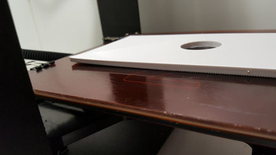

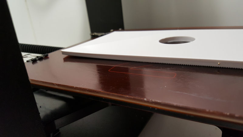

insta wrote:I print eSUN's ABS+ on MIC6+Kapton+nojuice.Jules wrote:I think you can use the ABS slurry directly on the MIC6,( right insta)? It's just flatter than glass, and it carries the heat all the way out to the edges. (Which you need for something that large.)
Talk to insta. He prints ABS on his MIC6.
ABS+ is the secret sauce though.
Picture below is eSun ABS+ on kapton with juice. I did not notice any difference in warp compared with regular ABS. This was straight out of the sealed bag too, no chance to absorb any moisture. Disappointed.
Re: PETG Infill Rot
abs+ still warps for sure. normal esun abs has a shrink factor of 0.8%. its been awhile since i tested it but if i remember right the abs+ was 0.65% so yes it warps less but marginal.
Re: PETG Infill Rot
Man, I was printing largeish (5x5") boxes straight on Kapton with no juice, with a 5-line brim and zero warp at all. I also had more of a first-layer smash than you do.pyronaught wrote:insta wrote:I print eSUN's ABS+ on MIC6+Kapton+nojuice.Jules wrote:I think you can use the ABS slurry directly on the MIC6,( right insta)? It's just flatter than glass, and it carries the heat all the way out to the edges. (Which you need for something that large.)
