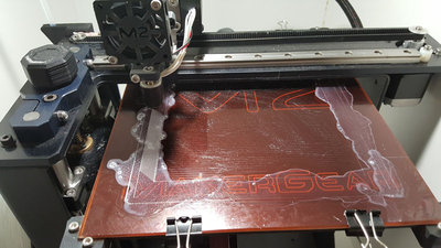

What I like about ABS slurry is you can control how sticky it is by the % of abs or the thickness of the layer you apply. There's the "nuclear option" where you squirt the abs juice on a hot plate where you know the perimeter will be and then you don't wipe it off. You just let it evaporate into a thick abs layer that acts like a brim and really grips the plate (see image below). You don't want to use that unless you absolutely have to though because the part is really hard to get off even even putting the plate in the freezer, then you have to wash the plate in acetone to get the mess off of it. But that nuclear option will beat PEI and rafts for holding the part down. The only thing stronger would be putting a raft on top of it.

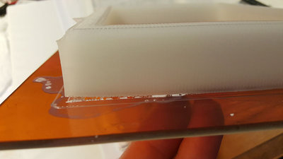

However, this part I'm currently trying to print is so warp prone that it is even ripping itself off the nuclear option (see below)! Normally once a corner goes the separation will spread around to the rest of the part and the whole thing will eventually come loose, but the sides of the box shown below still hold it to the plate for the remainder of the print. The corners don't peel till about two or three hours into the print once the wall height has reached about 1/2" tall, which is weird because that frame is really strong at that point and really hard to bend by hand. I really don't fully understand the mechanism behind how so much bending force gets generated by ABS. I wonder if it is really that the corners of the plate are cooler or if it is just that corners on the part are the most prone to start pealing. If I put a circle of the same diameter it will never peel, and rounded corners also seem less likely to peel. My theory is when you have a sharp corner that goes to a point, you have a spot that cools a lot faster than other areas because there is less thermal mass at that point. Then once the tip of that corner comes off the plate, it allows it to cool that much more and the reaction feeds on itself.
