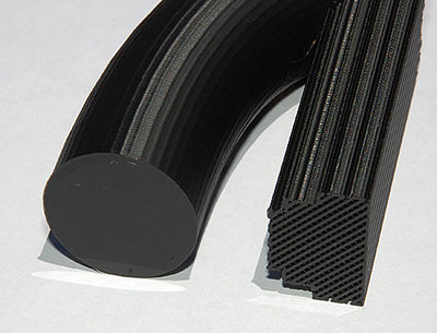

The one issue is that the portion of the cylinder that sits on the MakerGear platform prints some sort of bottom which is not part of the design. This is what I'm referring to:
On other prints when I select 100% Infill the bottom that sits on the platform is perfectly smooth.
What can I do to get a perfectly smooth bottom? Perhaps make the first few layers 100% Infill? Is that possible?

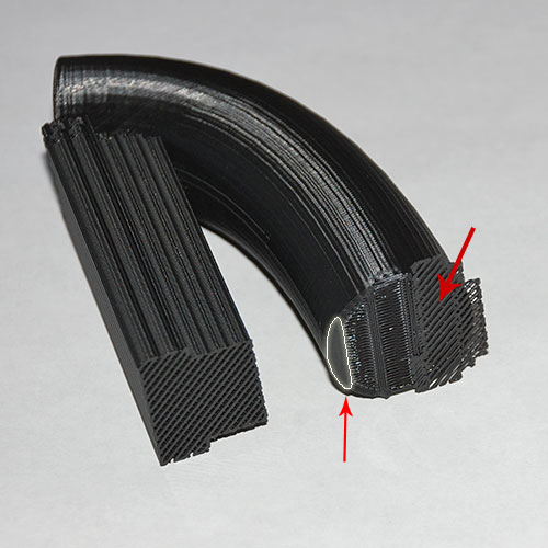

First off.....I've never used Sketchup, so can't tell you how to fix it in that program - but that is not a skirt, brim, raft or infill - I think that is Support that the S3D program generated for you automatically because the bottom of the print does not sit flush with the bed plate. It's got a very slight grade to it.
The only part of that print that sits flat on the bed is the part I've highlighted below:
If you are certain that your pipe has a flat bottom as designed, then the only problem is that when you designed it in Sketchup, at some point it got rotated just a hair off horizontal, and when you placed it in S3D, it picked up that rotation. (Or maybe it was rotated a bit in S3d - easy to do accidentally.)
Easy fix.....There is a button in S3D that lets you place a designated surface flat on the bed.
First raise the print high up off the bed (on screen) by double clicking directly on the print itself. Change the Z-Offset number to 100 mm. Hit Enter.
Then click Edit > Place Surface on Bed. Hover the mouse over the bottom face of the print and click on one of the triangles there. That places that face on the bed and re-orients it if needed.

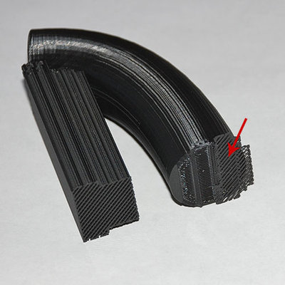

You nailed it. The problem was indeed the part was not laying flat on the platform. I did two things, first made sure the part in SketchUp is perfectly flat and second in the Simplify3D program I adjusted the following:
Layer -> First Layer Speed -> Default 50% now 25%
Here are the results:
Thank you for your wonderful help!
