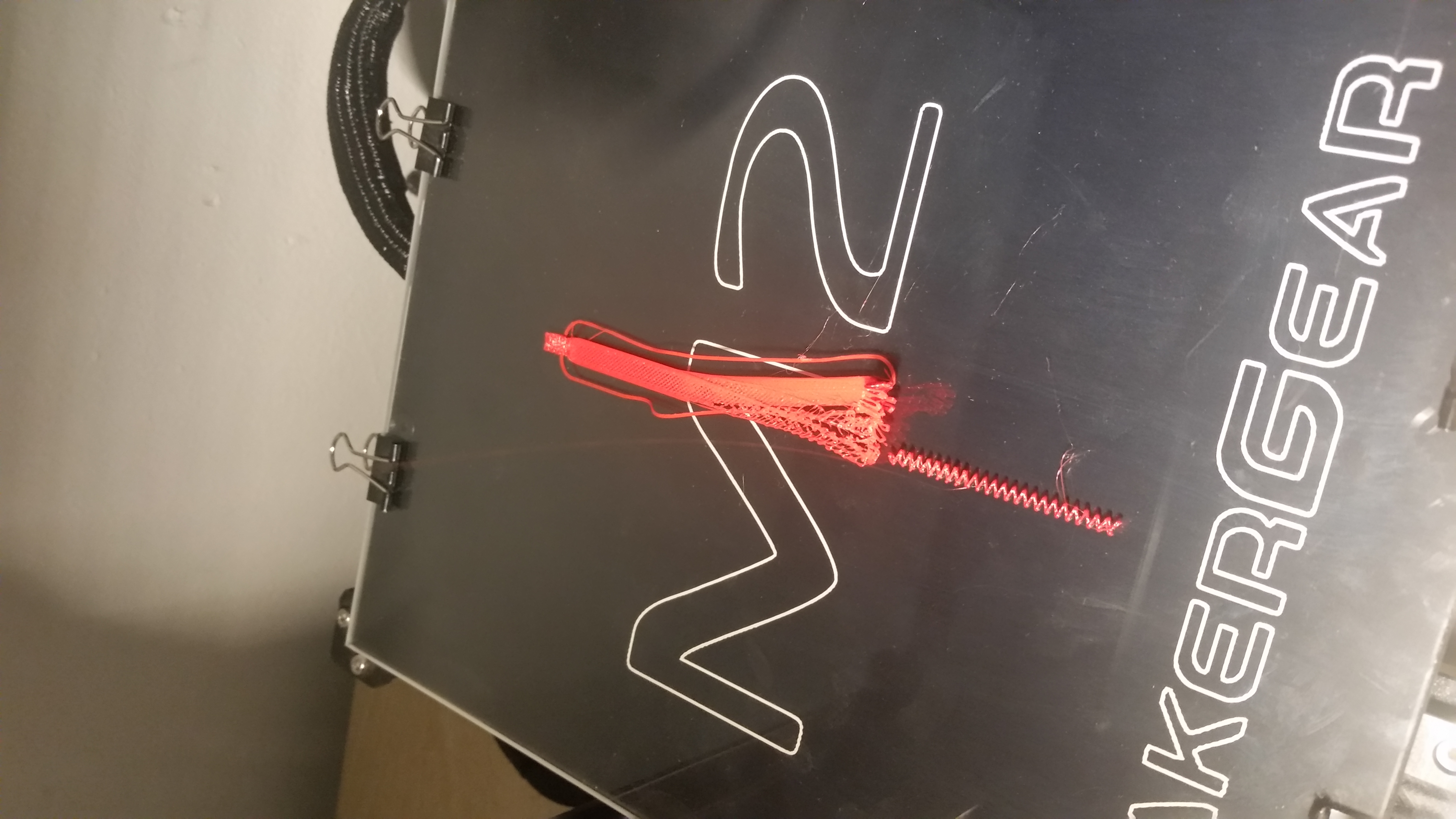

OK, I found the exact center of the plate and set the Z-end stop to .15MM. I then balanced the bed and was able to perform a successful cal to set the z-axis offset. I needed to make a 0.06mm adjustment. I re-caled and it was fine. The print appeared to be even, and then I tried to print one of my first projects. (see attached image)
For now I am going to try and re balance the bed then re-print. Any other suggestions?
