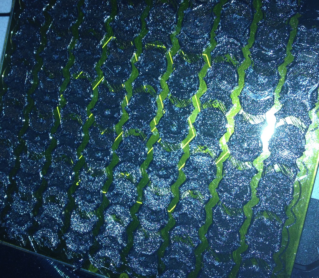

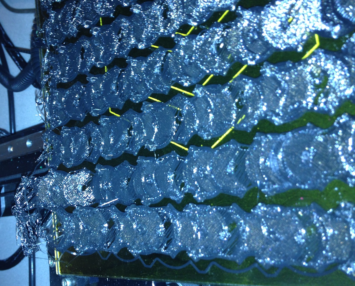

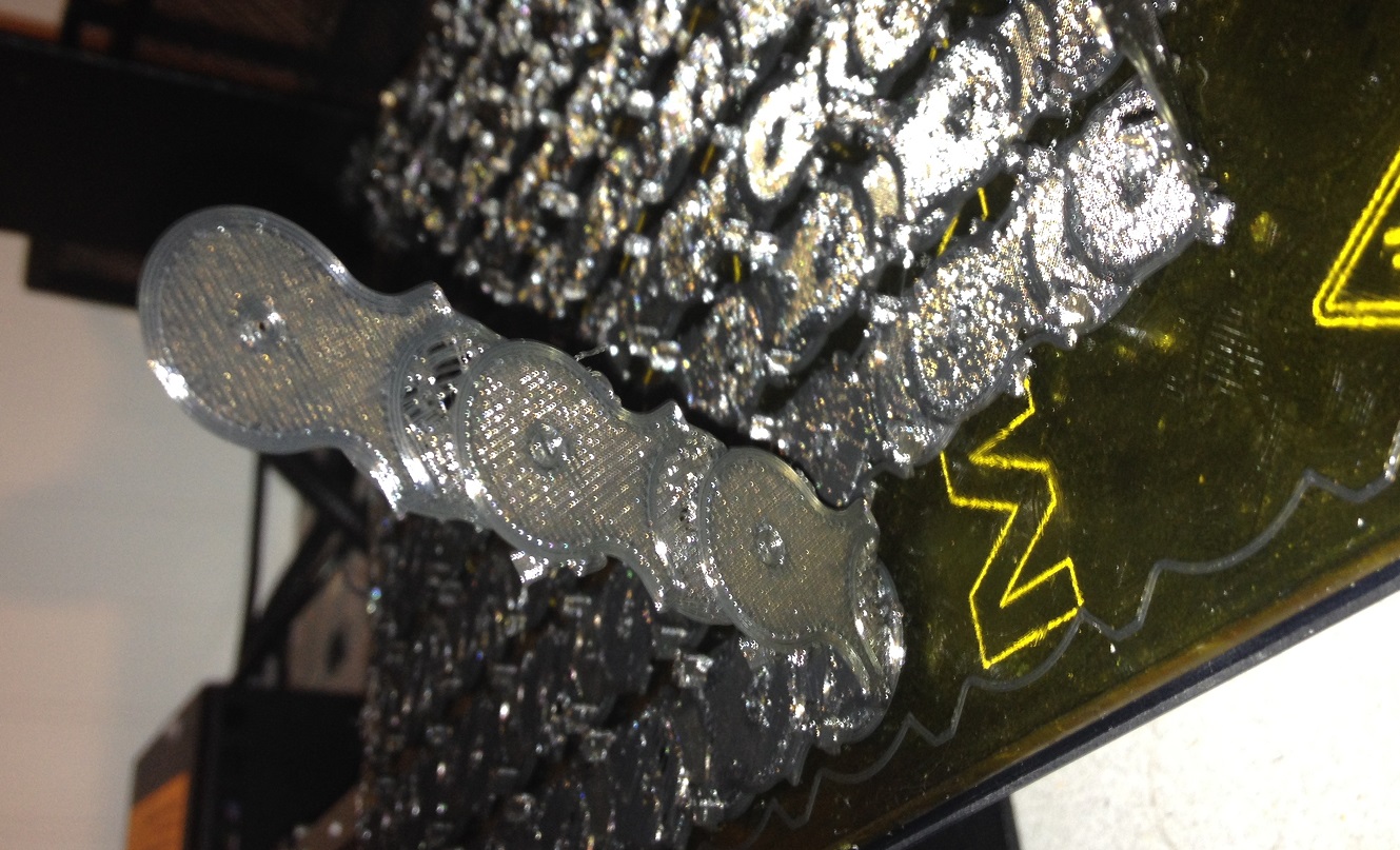

I have made about 5000 of these parts; just recently (past 2 batches) i have had the parts come out as if the x/y shifted during printing.
Example; 2 and 3 lather ok, but 4th on up are shifted 1/8"
Obviously makes the prints unusable; but I have no idea what is causing it. I have gone over the obvious stuff; any suggestions?
if it helps, one set printed fine, this happened, 2 printed fine, this happened

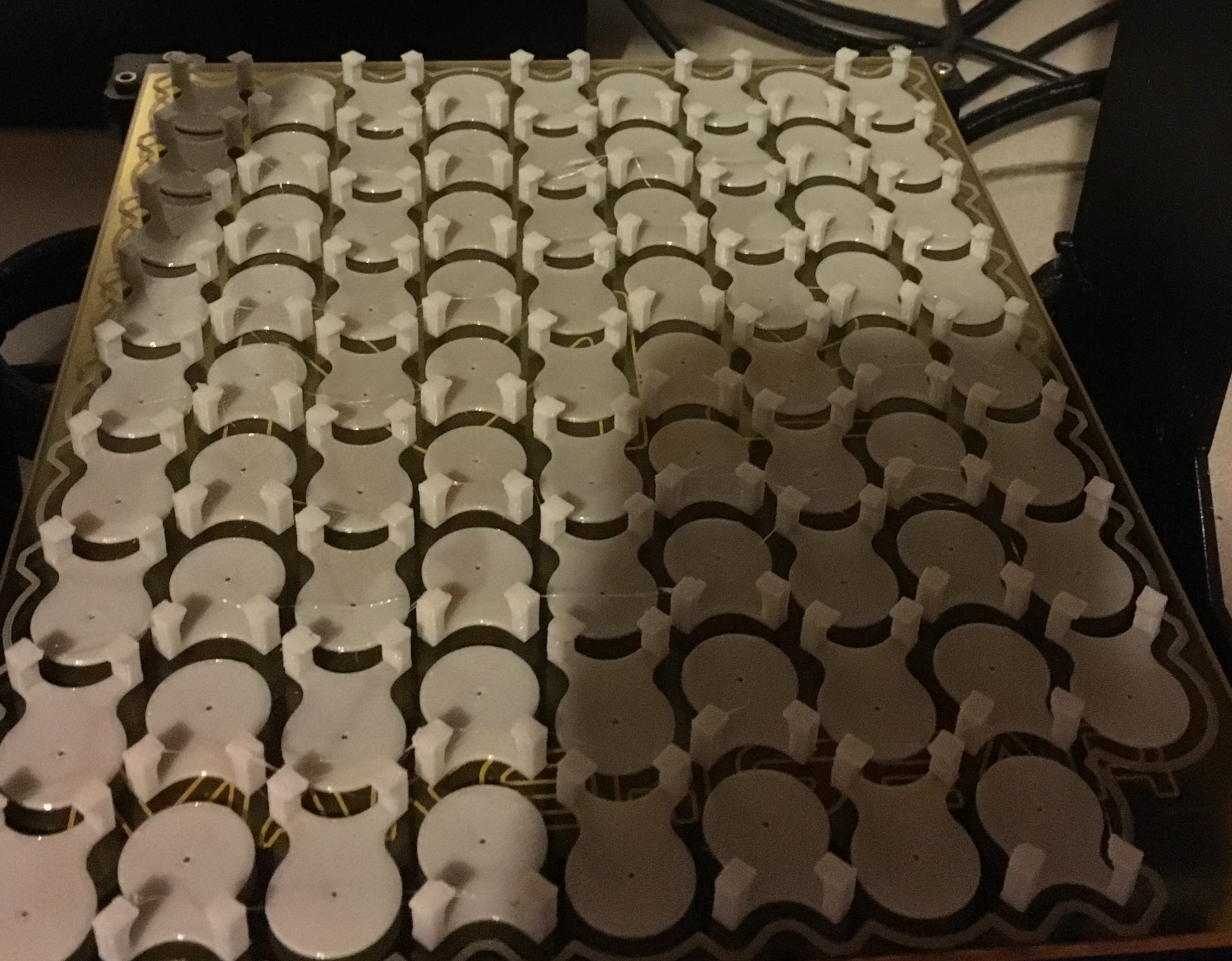

Also I do not an adhesion issue; the first few lays are stuck pretty good!
Also attached what a good run looks like, if that helps!

jcspball13 wrote:I have gone over the obvious stuff
One very obvious gotcha: I see at least three different filament colors.
Have you run temperature / speed / offset calibrations for each color, then verified you're slicing and running the appropriate G-Code file for each filament color?
Given that each of those parts has two delicate overhangs, I'd expect one of those little tabs to curl upward, snag the nozzle, and wreak havoc. Given the number of parts on the platform, even a slightly incorrect temperature / speed / offset will increase the likelihood of failure ...

Same exact file; same color that worked before with same settings
It actually 2 colors: grey and black, pictures just must be bad!
The weird part, as I said earlier, was that the 2 runs before the last one, same color and settings, ran fine!
And then blamo, this bad one
I a going to try and go back to the grey and see if it happens again; any help still greatly appreciated
