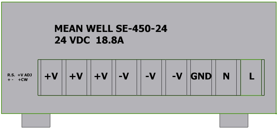

Tshulthise
Posts: 28
Joined: Wed Apr 09, 2014 8:44 pm
Re: Need to run MakerGear M2 off remote battery power
Post by Tshulthise » Sat Apr 19, 2014 4:50 pm
rixpix247 wrote:...Can you tell me what the 24v power supply specs are and its multiple outputs?
Thanks in advance again!
See attached rendering for M2 24V PS info.
M2 24VDC POWER SUPPLY.jpg (61.69 KiB) Viewed 15083 times

Super! Thanks for the 24v diagram!
Post by Mark the Greater » Wed Aug 19, 2015 2:51 pm
If he just bought one then this is not the same PS.
