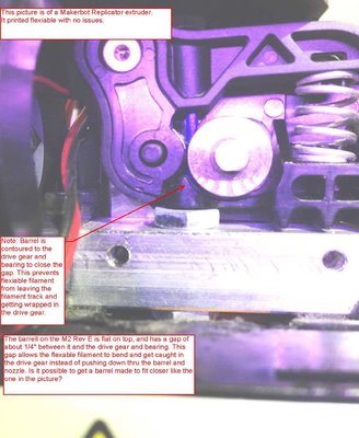

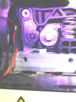

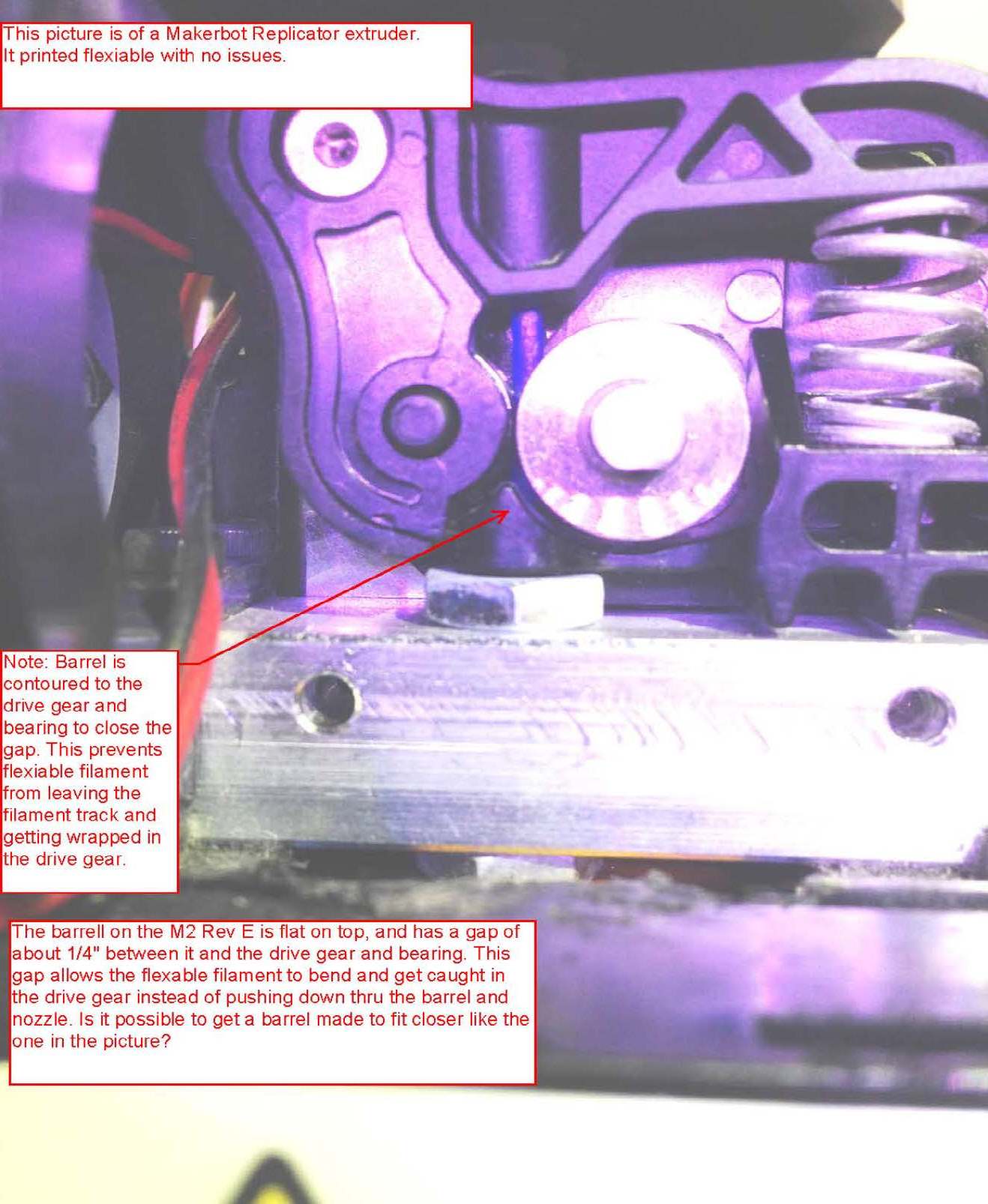

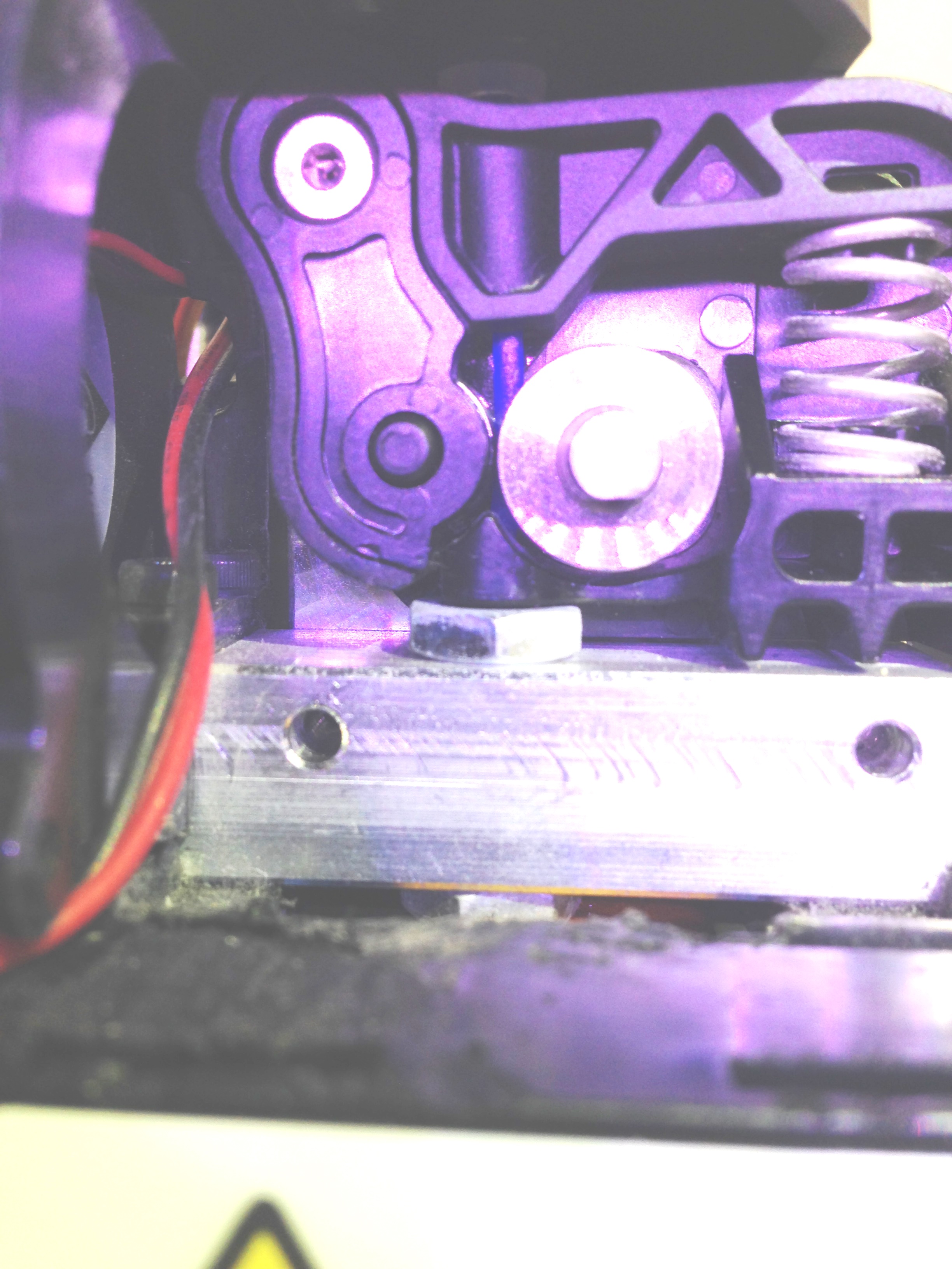

I recently tried to print Ninjaflex flexable filament on my Rev E M2 with no success. No matter how slow I fed the filament, I never could even get it to load. As soon as the filament hit the nozzle, the back pressure caused the filament to flex and it would get wrapped in the drive gear. Upon closer inspection after pulling the extruder apart multiple time to unwrap the filament, I notice that there was a fairly large gap between the top of the barrel and the drive gear/bearing, which allowed the filament to bend instead of pushing down and thru the nozzle at the other end of the barrel. I brought the filament to work and tried it on a Makerbot Replicator 2 we have there. The filament loaded first time with no issues, printed perfectly each time. I pulled the fan to look at the barrel and drive set up and noticed that the barrel conforms to the shape of the drive gear/bearing and there is almost no gap to allow the filament to bend. See picture attached. Is there a way to have a barrel made for the Rev E that would contour to the drive and adjust to the close the gap in a similar manner?

Here is the picture with comments on it.
