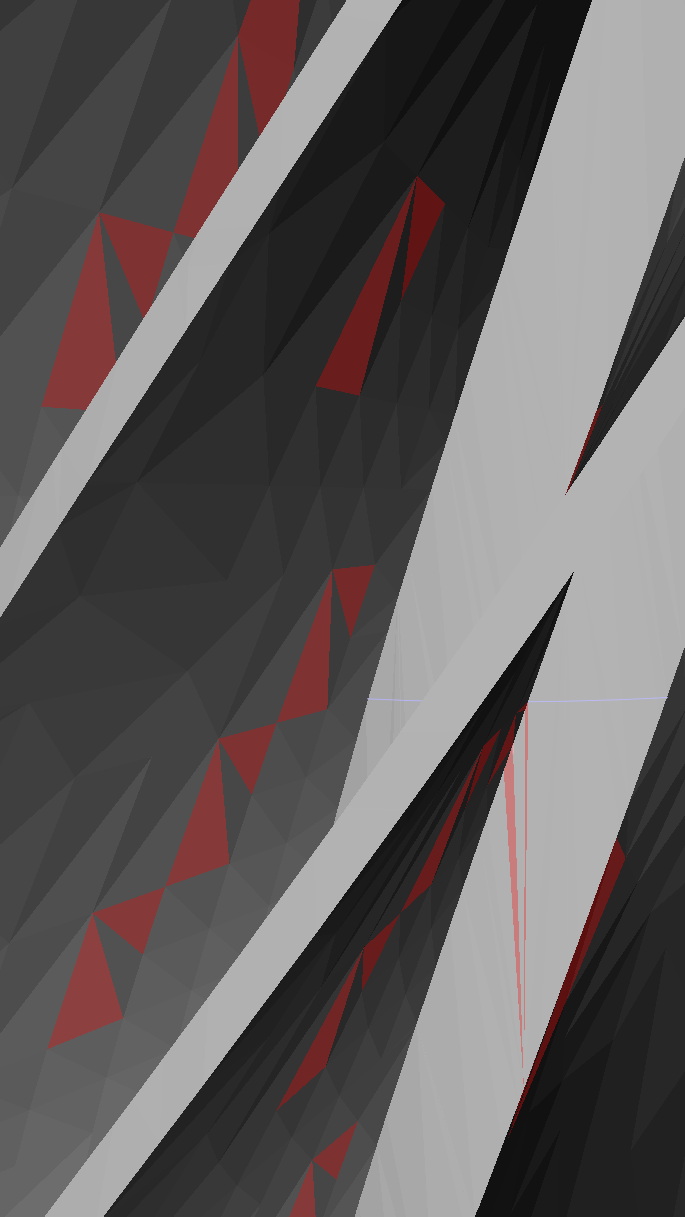

Meshlab shows a gazillion self-intersecting faces, so that model isn't ready for slicing.w22 wrote:attached the current print
