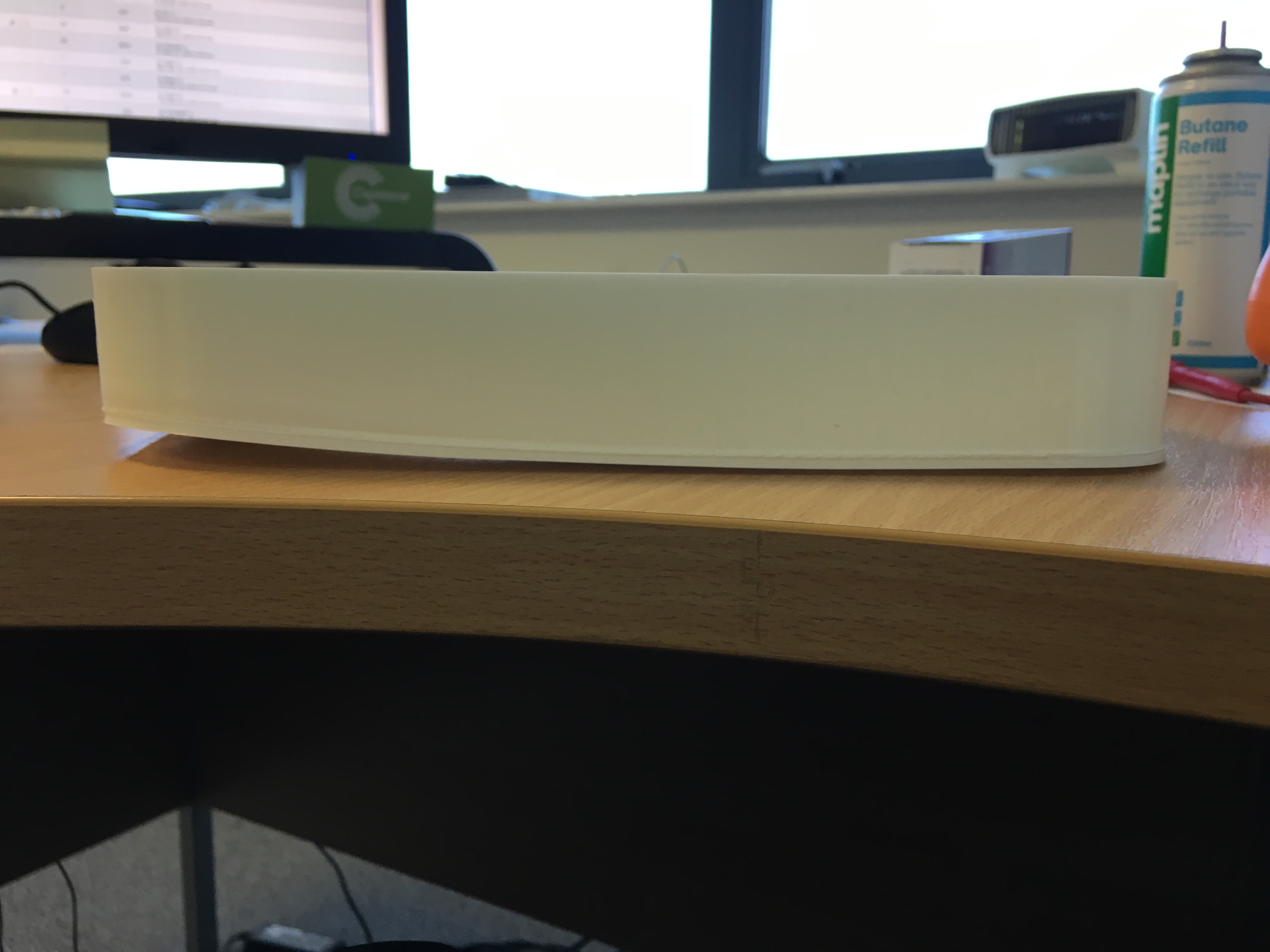

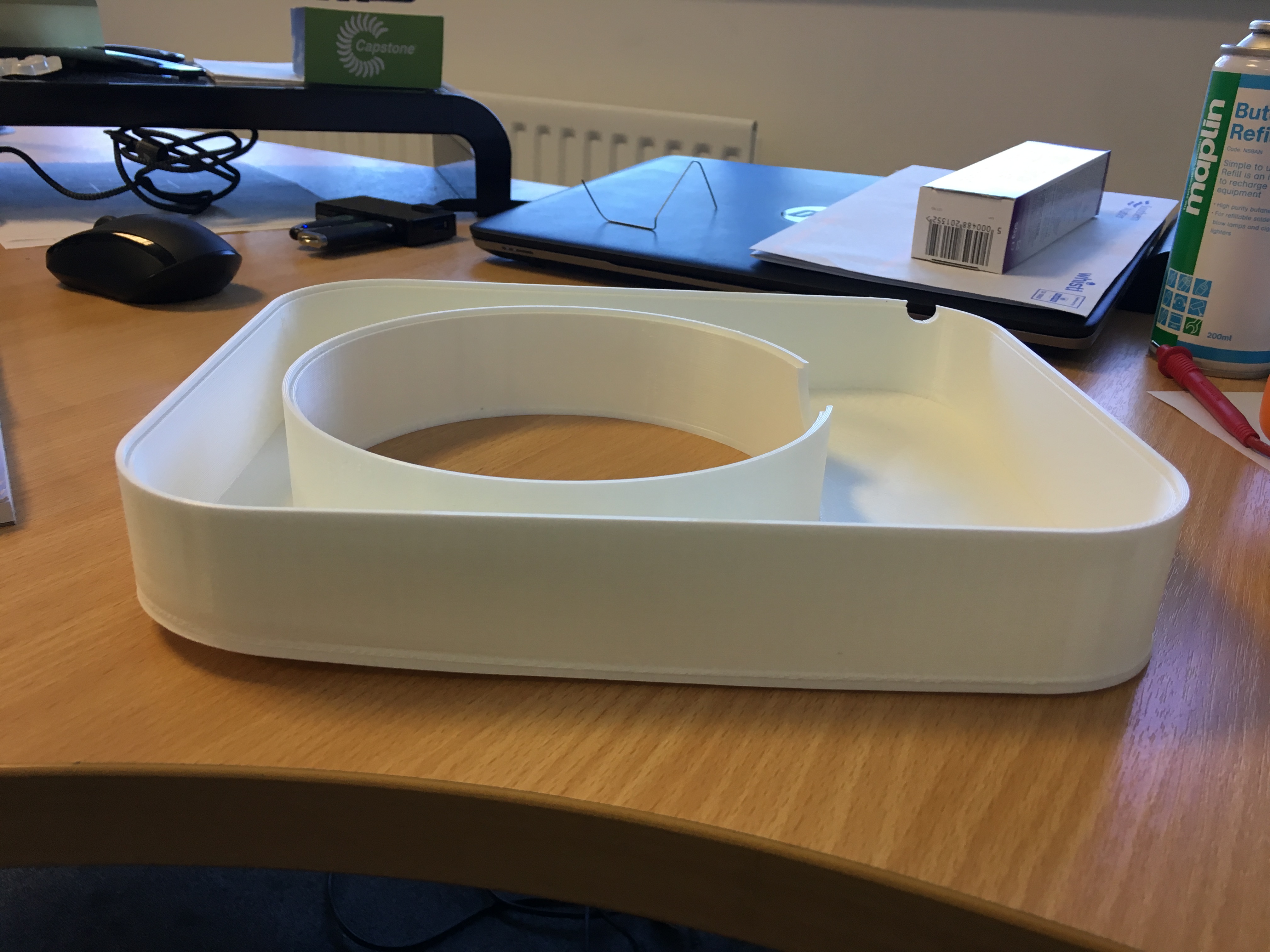

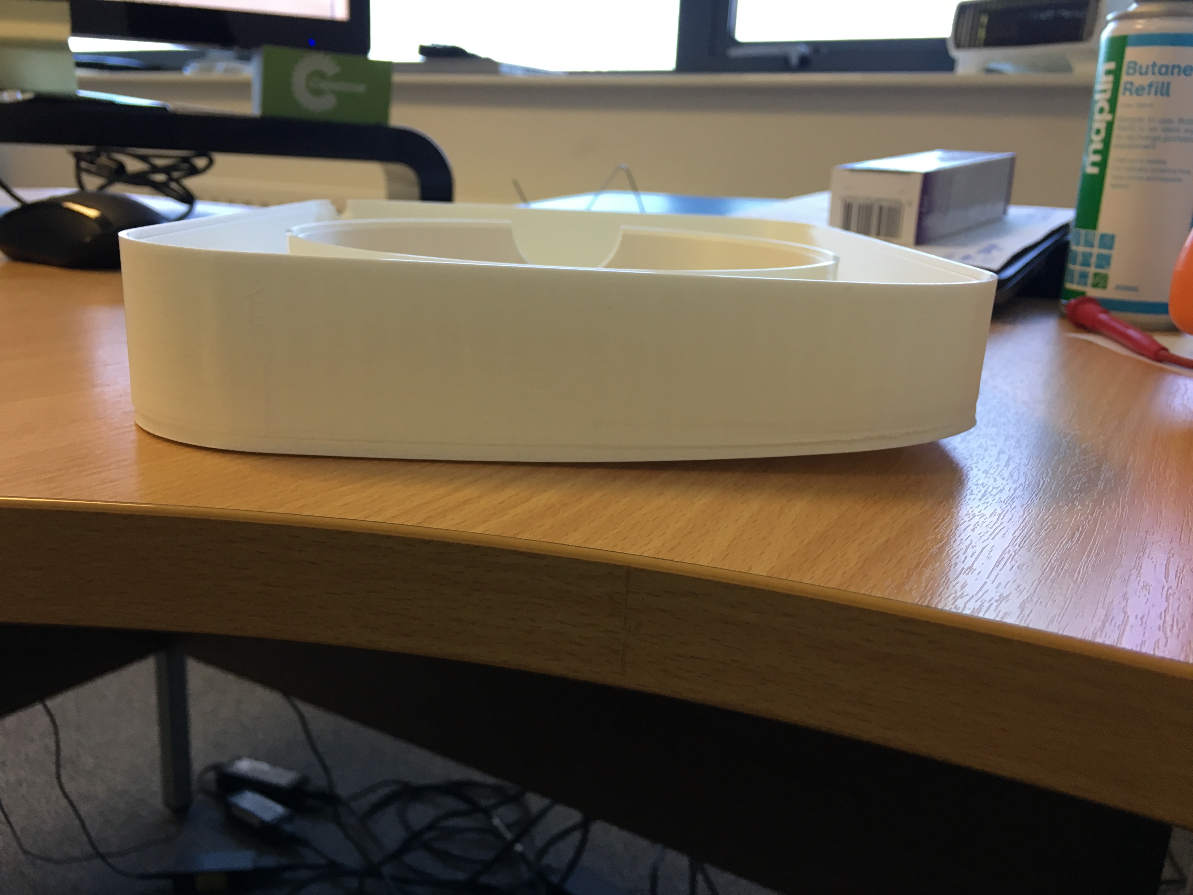

I printed an object that fills the entire print bed, and while the first few layers went down well, I woke up this morning to find the print had warped at the corners quite significantly. I was quite surprised to see this as the corners have a fairly large radius and the first layer was squished well. This was printed on top of a MIC6 and PEI sheet that has been lightly sanded. Print temp is 213 and bed temp is 50, 2 outer layers and 4 bottom layers. Here's a few pics:
Before I re-attempt it with a few tweaks, I was hoping to get some input on how to eliminate the warping. Should I try lowering print temp, increasing bed temp, lowering cooling, or a combination of the lot?! I'm also going to try sanding with a slightly coarser paper in order to provide more tooth and go for a bit more squish on the first layer, but after that I am at a loss.

Was it printed in ABS? Typically, thin walls and ABS usually leads to warpage and cracking if it wasn't printed in some sort of enclosure to keep the surrounding temperature stable.

Plastic shrinks as it cools, so those tall walls want to be much shorter than the flat base on the platform. Two walls pull on each corner, with the resulting force aimed inward (toward the bisector of the wall angle). That force pulls the corner up and off the platform. There is no good solution, because ... the force isn't with you.ryaneb85 wrote:some input on how to eliminate the warping
It's worse when the edges have stylin' bevels / chamfers / rounding that reduce platform contact directly under the walls, giving the forces a running start on pulling the bottom off the platform. It's not obvious what the original design looked like, but the corners suggest a smooth outline.
Things to try that probably won't work:
- Add mouse ears / lily pads outward on each corner, then remove & repair the damage.
- Flip the object upside down, put a ton of support inside, and spend a day cutting it out.
- Bottom plate with very short walls
- Sections of the outer walls
- Sections of the inner walls
Previous discussion about a similar shape with similar adhesion problems:
viewtopic.php?f=2&t=4546

Personally I would use hairspray on the MIC6 Plate, and forget about the PEI.

This was printed in PLA with no fancy bevels etc. It's a shame to hear that it might not print well. This is a personal project and I purposely avoided sharp corners thinking they were much more likely to warp than rounded corners, but it sounds like corners full stop are not good!
Do you know how many layers work best for mouse ears? I've tried them before with 1 or 2 layers, but they didn't make much of a difference. Maybe it's the thicker the better!
Do you think the walls would print fine without the bottom plate? I'm not much interested in the surface finish of the print, so I'm thinking I could print the bottom plate and walls separately, then drop the bottom plate in on completion. It might actually help me out having the bottom plate removable.

If it's a thin full bed print with PLA....I will sometimes add hairspray onto the PEI sheet directly. I don't need to do it often, but it does make everything stick well everywhere, and if it's a warp-prone print (like that one) you need to increase the sticking power.
Other thing with that kind of print - let it cool completely to room temperature while it is still attached to the plate (overnight) before you try to take it off of the plate. PLA will keep warping and twisting after it cools, until it sets into shape. Leaving it attached to the plate keeps it in the right plane while it sets.
Increasing the infill also helps to keep it from twisting after it cools.

hmm thanks Jules. I may try some hairspray tonight. I thought a layer of hairspray would cover the PEI and basically negate it's effects.
Is bed temperature going to make any difference? In my mind making it hotter is going to make things worse, as the temperature differential will be higher, but I've seen other suggestions saying it makes it better. Maybe it's stickier when it's hotter?!

It's the surface area in contact with the platform, rather than the thickness, that matters: two layers should be stiff enough to anchor the wall, if the ear doesn't detach from the platform. However, if the walls apply more force to the ear than the platform, then the ear will pull loose, no matter how thick it is. Making the ears big enough ("elephant" rather than "mouse") will do what you need.ryaneb85 wrote:how many layers work best for mouse ears
Definitely not: they're already exerting more force on the corners than the plate can counter: reducing the footprint to almost nothing won't help.the walls would print fine without the bottom plate
If you're doing separate walls, turn the ears into complete circles at the corners. That will provide the same area outside the wall, plus add stiffness inside where there's still some lifting force.
Reducing the wall height, perhaps by cutting it in thirds and printing the pieces (and the base) separately, should improve the situation. After that, ears / circles may provide enough adhesion to anchor the corners.

ok thanks Ed, I think I'll try to give ears a go first. Although the bed is almost all in use, so I'll just have to fit in what I can where I can!

If this is an object of your own design, you can also try incorporating some anti-warp features. I've seen people experimenting with accordioned walls to reduce the pulling forces, or you could try introducing a vertical slit in the walls on both sides of a corner.
