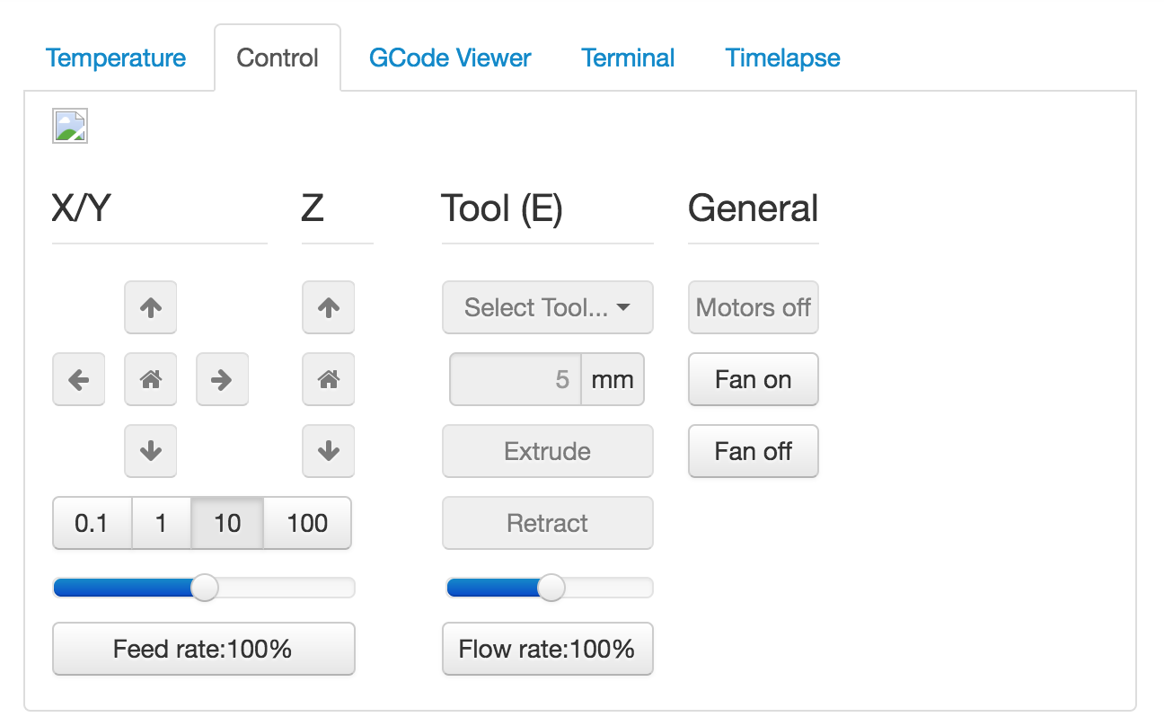

ksevcik wrote:If it's just the bottom that's leaking, maybe you could try over extruding somewhat while you're printing the bottoms layers. In Simplify3D, you'd go to the printer controls and crank up the extrusion dial to 110% or something while you're printing the bottom, then knock it back down to 100% for the rest of the print. I also saw a comment in the 3dprinting reddit boasting of using a 0.8 nozzle and getting watertight single shell vases.
I use Octoprint to control the printer. Is it the flow rate I would increase?

Flowrate in that case, yes. I'd guess getting it timed right through octoprint will be a bit trickier, though. You could set up a pause after the last bottom layer, but you'd get a little ooze.
