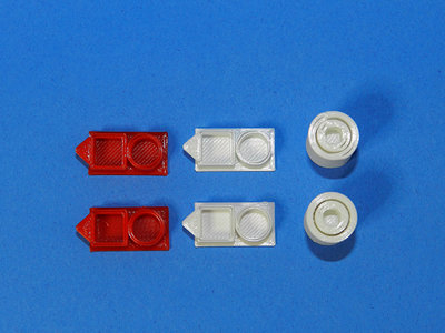

Looking to the group (again) for some feedback and suggestions on an issue I've encountered printing round objects. Cylinders aren't round and have flat spots on them. This print shows what I'm talking about:
Looks like a classic backlash issue, but I'm not sure how to go about correcting this on the M2. I do have the nema dampers on the X and Y motors. Steps I've taken so far:
-Tightened belts (they didn't feel loose though)
-Ensured the gears on the motors that drive the belt are tight on their shafts
Any help is appreciated!
Edit: Just as a test, I removed the dampers, but it had no effect. Test prints were identical.
I don't know if this is a recent problem or not since I only found it when trying to print cylinders that are meant to go through holes in another print. Looks like a classic backlash issue, but I'm not sure how to go about correcting this on the M2. I do have the nema dampers on the X and Y motors. Steps I've taken so far:

Are the flats in the x or y direction? The problem axis is always perpendicular to the flats.
Re: Cylinders aren't round
Hotend is all tight.
The flats are along (parallel to) the X axis, which means it is a Y axis issue. I can find no slop or play in either axis.
I also cleaned and lubed the axis rails to eliminate that as an issue.
Printing through OctoPrint and connected directly to the computer via USB produce identical results.
Went back to some of my earliest models that have round components and the flat is there also. I just didn't notice because it is pretty small and I wasn't trying to fit any pieces together. The difference in diameters of the various round things I've printed is around 2% with the X axis being the correct diameter and the Y axis being smaller. Even though the Y axis prints smaller, the flat spot is creating a bulge at the 10 and 4 o'clock positions.

This is the calibration object shown in my original photo:
