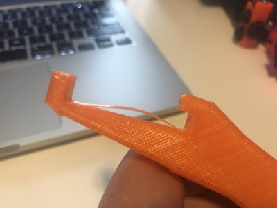

Printing with eSun PETG Orange (which is a translucent) on boro with hairspray. I used Jules guide for the Black PETG and it printed well except the perimeter is separating. Here is a picture. Not sure how to fix this issue.

Infill tab, Outline Overlap, Increase it. This will ensure that the infill layers make solid contact with the perimeters, and hold it all together.

3dPrintingMD wrote:Infill tab, Outline Overlap, Increase it. This will ensure that the infill layers make solid contact with the perimeters, and hold it all together.
Thank you. It was at 10% and I increased to 15%. Reprinting now.
Re: PETG Perimeter Separation
Post by jimc » Mon Dec 19, 2016 4:53 am
ummmm not really. outline overlap is how far the infill overlaps onto the perimeter not how much each outline overlaps onto each other. your perimeters arent bonding to the one next to it because your extrusion multiplier is too low. your not extruding enough filament to make the extrusion width as wide as its supposed to be. basically in real life your extrusion width isnt what you have it set to in the slicing software. you tweak this with the multiplier.
