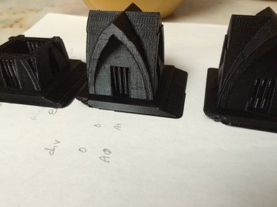

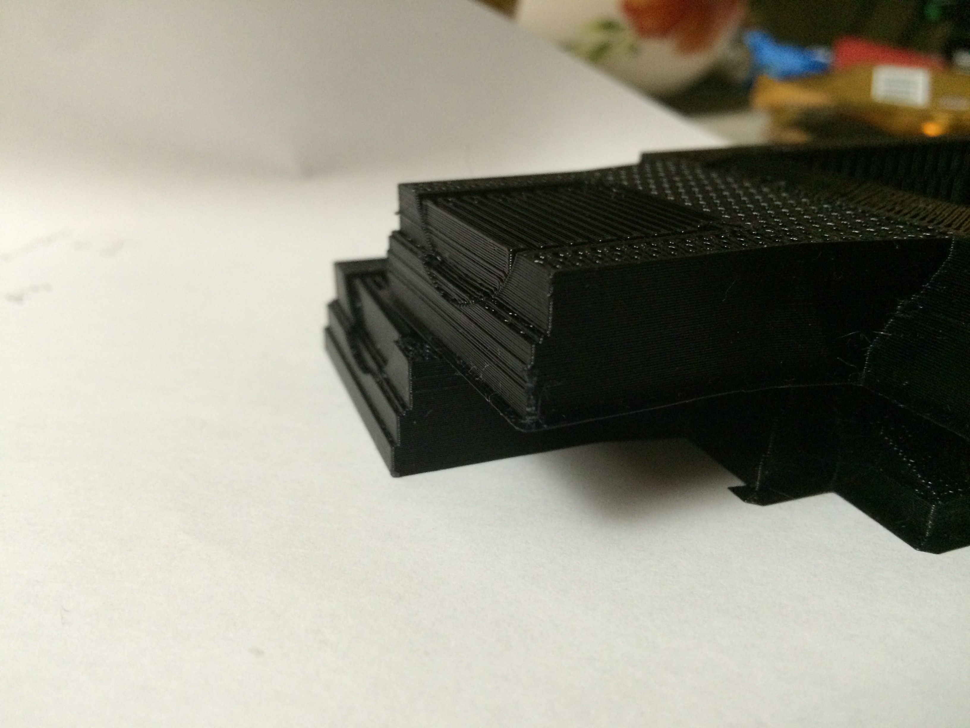

this Y slipping has been going on for a while, unable to get a print out of it (in the middle of a run!)
Everything is clean, going to check the pulley and belt ASAP but I wanted to pick the collective brain.
Seen this in the Y direction?
I promise to update when I figure it out.
Image is of a test file that is known to print OK. (PETG)
y slipping

Is the base of that design supposed to look like that, with steps on the front and an overhang on the back, or was the slipping happening on the bottom too?
Just to make sure I understand what happened there......is that the right side of the print as it sat on the bed? (Y axis slip) Or was that facing you? (X axis slip?)

The base is supposed to be a rounded rectangle with vertical edges; I just printed off the SD card and it looks the same, however the steps are not 100% consistent. Every print I attempt has errors like this now.

Sorry, also all the slipping is on the Y AXIS, seems to be toward the motor end of the bed; checked belts and pulleys and for debris, everything looks and feels great.

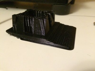

When I get a moment I can check the fail bin for a rogue's gallery of Y step, or creep; almost certain all of them step back toward the motor end erraticly.

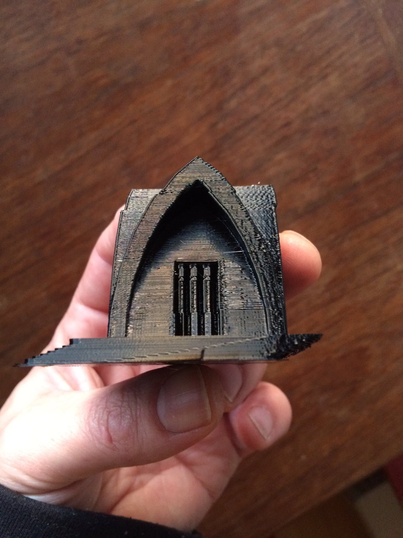

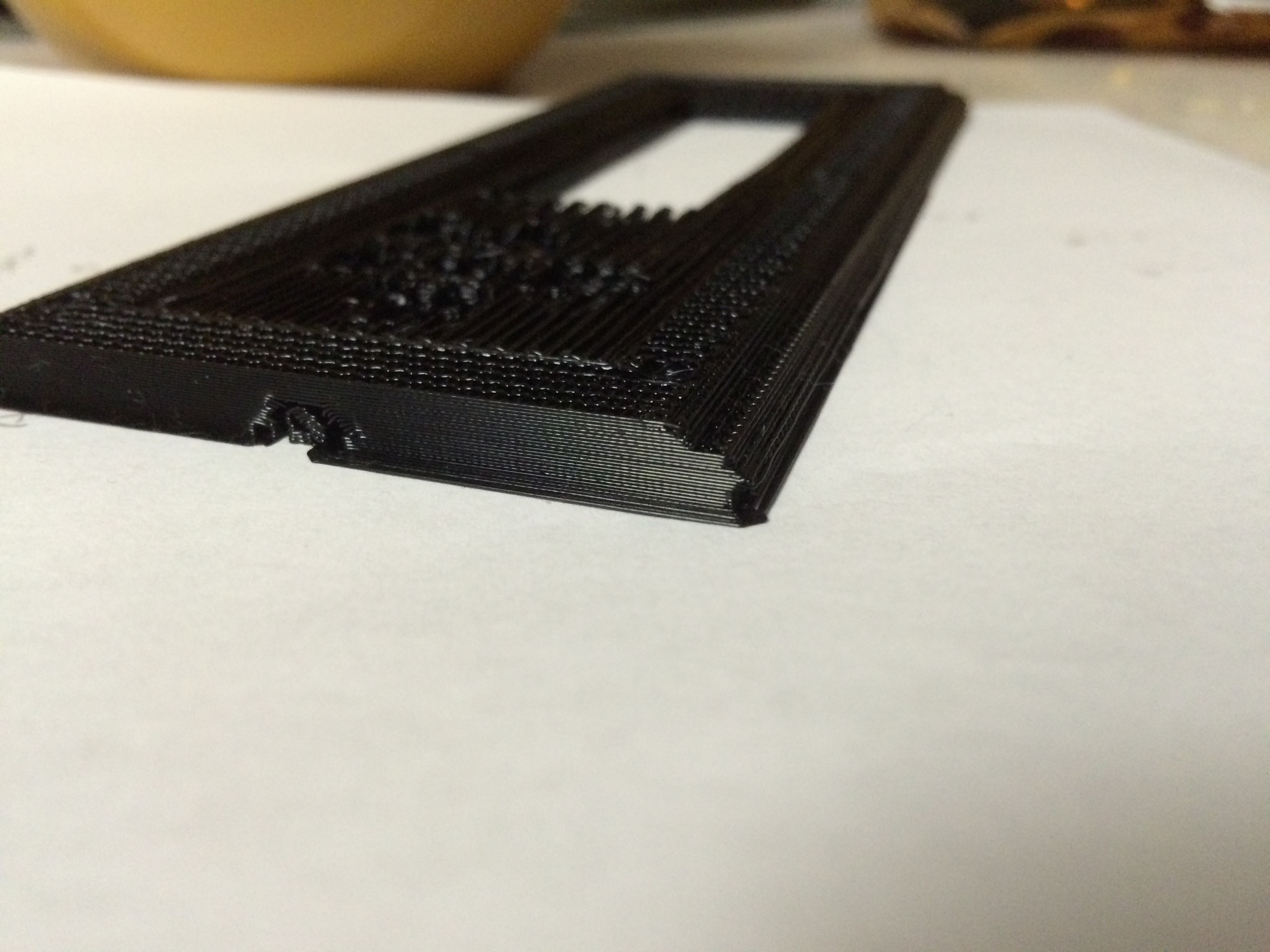

Here's an early example, I thought someone was bumping into the bed! All shifts are on Y axis, supposed to be a flat vertical surface:
EDIT: I print with a brim, that first layer isn't a shift.
Y shift on vertical surface

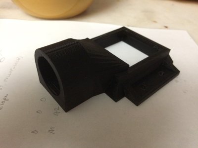

Post by dobart » Thu Feb 16, 2017 5:26 am
This cover plate should have a 45 degree angle; I've printed at least 6 of these with various other jobs no probem
