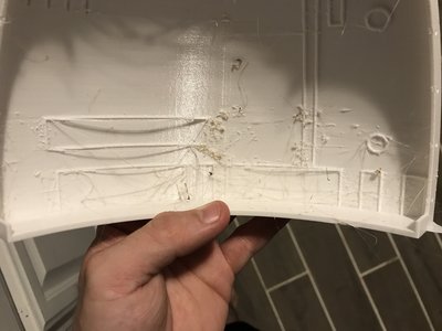

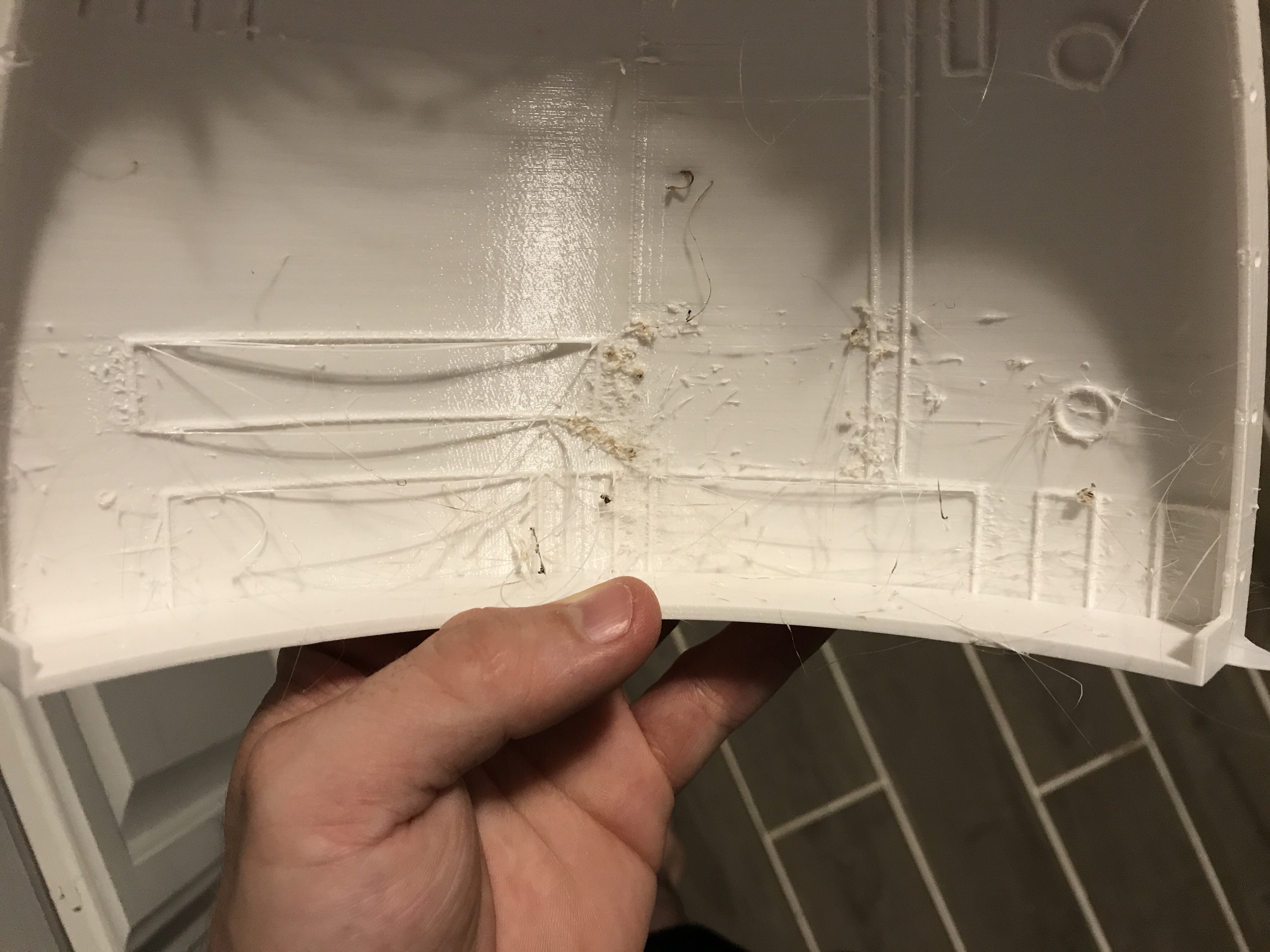

I've read other posts on the forum about printing PETG and have adopted most of those print settings, but I'm still experiencing some issues. The outside of this piece looks pretty nice, but the inside surface, where all of the layer changes occur looks pretty bad (see attached picture). It has blobs, strings, and burnt bits all over. Here are some pertinent print settings:
Hatchbox PETG
240 extrusion temp
50 bed temp
0.88 extrusion multiplier (I use 0.89 for PLA)
2 mm retraction
5 mm coast
45 mm/s print speed
Any idea what could be causing what is in the picture?
Diagnose this PETG problem
Re: Diagnose this PETG problem
The actual value of the multiplier isn't important, it's whether the extruder produces the correct thread width: if you haven't printed and measured a thinwall calibration square to set the multipler, do so. The correct value ensures you're not overstuffing the part and should reduce the dreaded PETG hair problem.alackofcolor wrote:0.88 extrusion multiplier (I use 0.89 for PLA)
After you have a calibrated extruder, then reducing the setting slightly will starve the extrusion and may further reduce PETG hair. However, the top and bottom surface fill may suffer, so proceed carefully.
It looks like many of the perimeter threads pulled loose from the infill on those protruding features, which happens more on concave surfaces like the inside of that sheet. Print the infill pattern first, then the perimeter threads, so they have something to hang onto.the inside surface, where all of the layer changes occur
Turn on "Avoid crossing perimeters" to keep the nozzle inside the part. However, that may cause problems with PETG, because skimming the nozzle over the already-printed interior may collect too much gunk on the nozzle.
Also, preview the G-Code to verify the model doesn't have any problems that produce weird paths. I doubt that's the case, but it's always good practice when you see random threads hanging all over the place: the nozzle may be putting plastic in mid-air because the slicer had trouble parsing the model.

Yeah, there are a bunch of threads that aren't catching on the protruding features on the underside, like you've mentioned. I've seen that on PLA prints of similar shape as well, but it's especially bad here. When you say print the infill pattern first, and then the perimeter threads, are you saying to use the Outline Direction: Inside-Out in Simplify3D? I'm doing that already. But if you mean something in addition to that, I'm not sure where that setting is. Thanks for your help.It looks like many of the perimeter threads pulled loose from the infill on those protruding features, which happens more on concave surfaces like the inside of that sheet. Print the infill pattern first, then the perimeter threads, so they have something to hang onto.
I use Slic3r, so I don't know what S3D calls things.alackofcolor wrote:Inside-Out in Simplify3D? I'm doing that already.
Slic3r has two settings:
- "infill_first" does exactly what you think it should
- "external_perimeters_first" lays down the outer perimeter first, then works inward
If those features aren't faired into the surface and have too much overhang (particularly on the concave side), then building them from the inside out won't help: without supporting threads underneath, the threads will fall loose. Perhaps tweaking your model so the bottom of the projections extend at 45° will improve the results.aren't catching on the protruding features
You should also force the slicer to put all the layer starts in a column, so it doesn't (try to) start a thread in the middle of an overhang.
