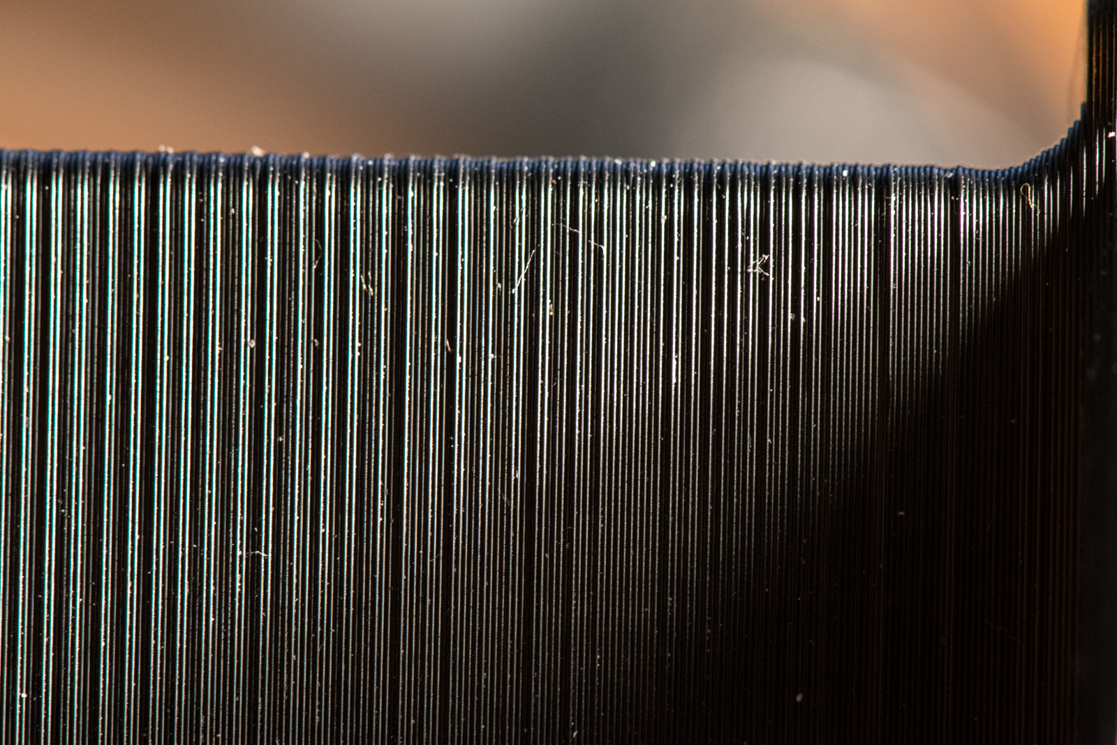

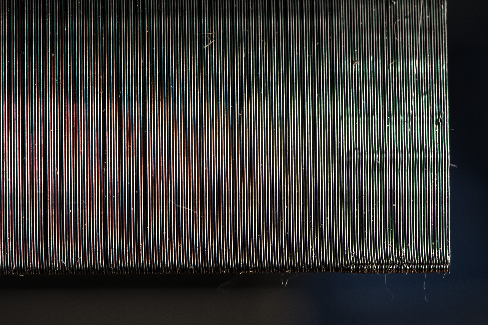

Here is a photo of the part where I see waves not unlike what you have posted.
To the left is the wavy end. The split is about mid point in the image. The right side of the image still shows surface imperfections, but they are not cyclical.
Here is the same part lit at 45 degrees. Personally I think it's a pretty good looking print. This was run with a .35mm nozzle, and I think the layer thickness was .17mm.

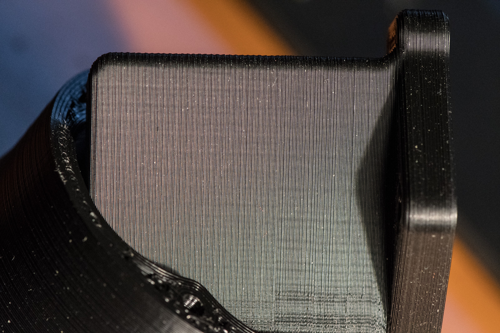

Just for reference, here is another ABS print I ran recently. There are internal features which impact the outer surface which result in the ridges you see on the right side of the image. I lean toward slight over-extrusion to improve perimeter and layer bonding strength and that probably makes things a little worse. This part was run with a .5mm nozzle and .25mm layers.
