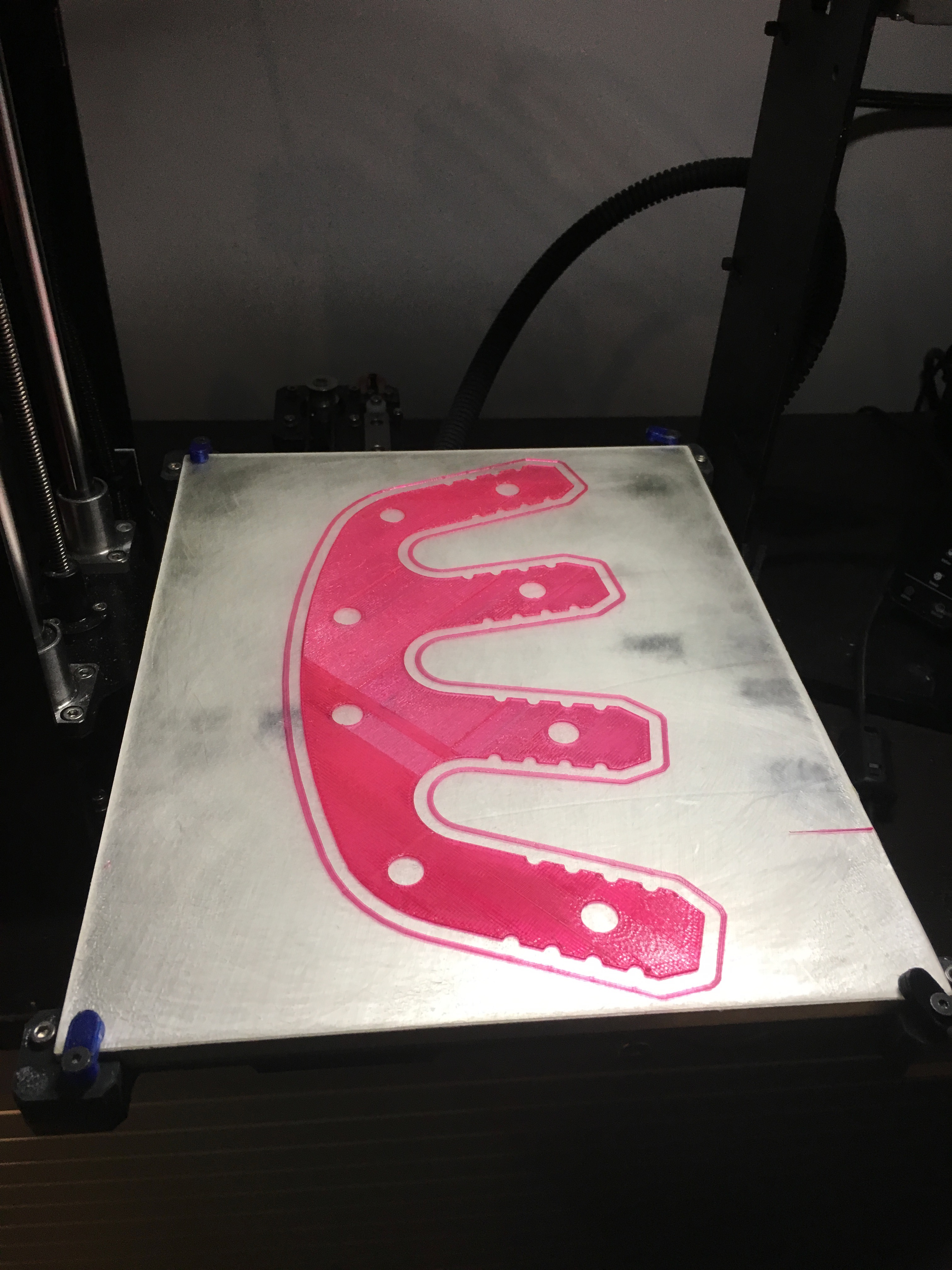

failed print on bed

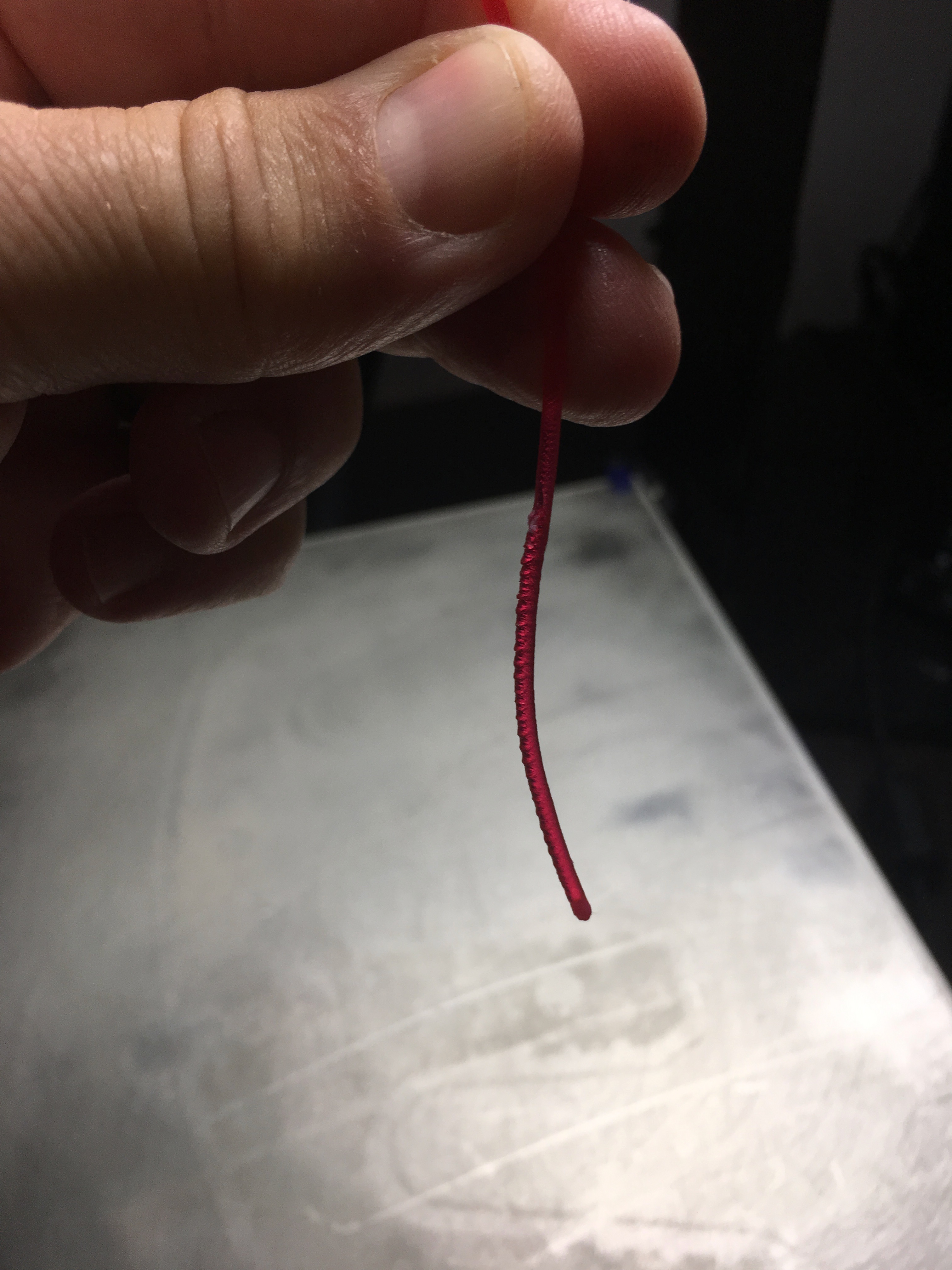

filament with extruder teeth

I have just been trying to print a 2 hour model at least 3 -4 times with fails. I did get 2 good prints out fully, but others have failed.
It prints well for a few layers, I leave it to print over night or sometimes just leave the room, when I come back, it has only printed 3-6 layers and the machine is either air printing or has homed and stopped.

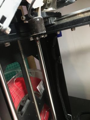

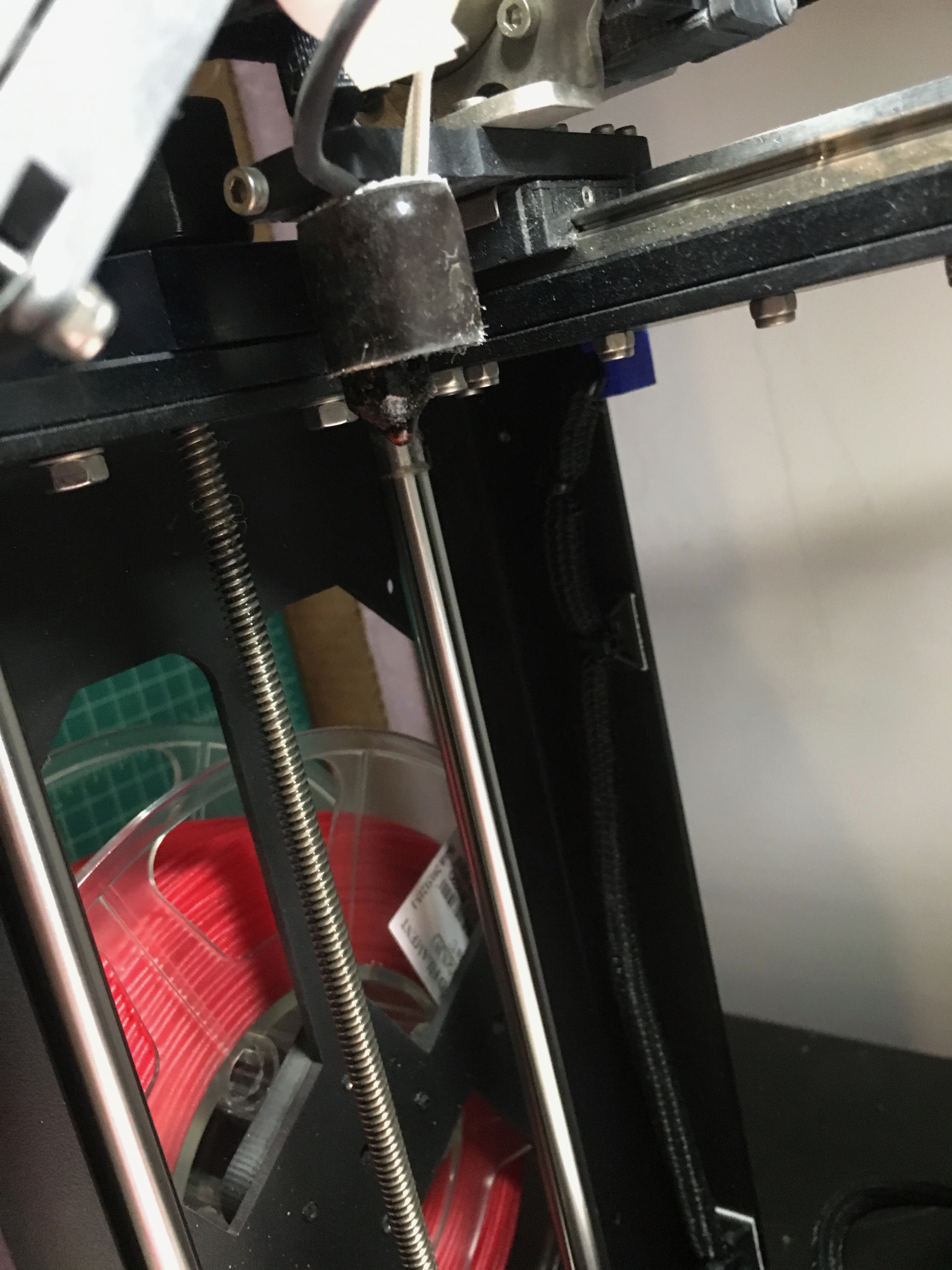

The nozzle is not blocked, the extruder seems to be set for the right tension, getting the right teeth marks in the PETG filament, there are no knots in my reel.

Cant speak definitively but try lowering the tension on your filament. You might be compressing it too much and causing it to stop feeding.
